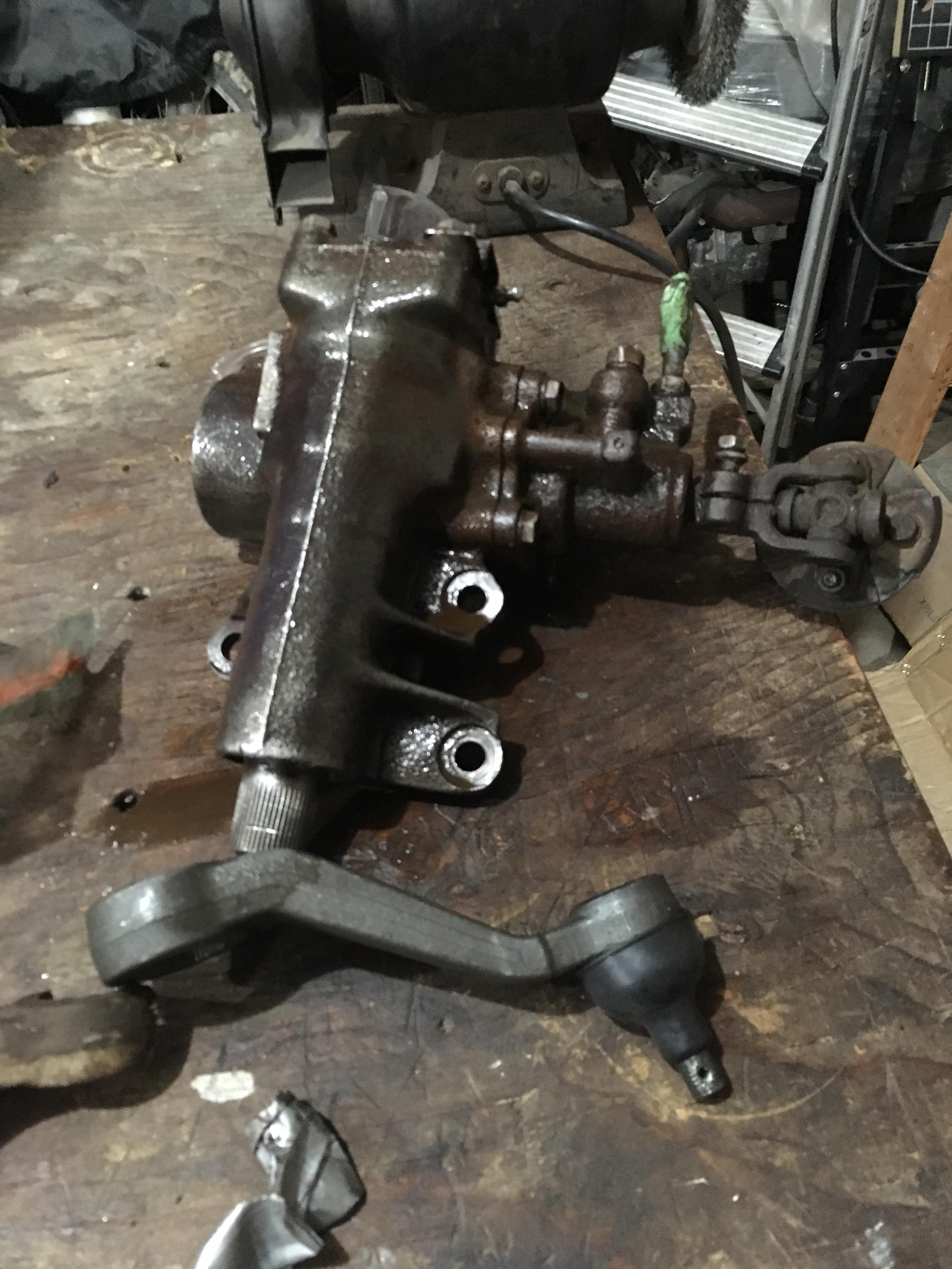

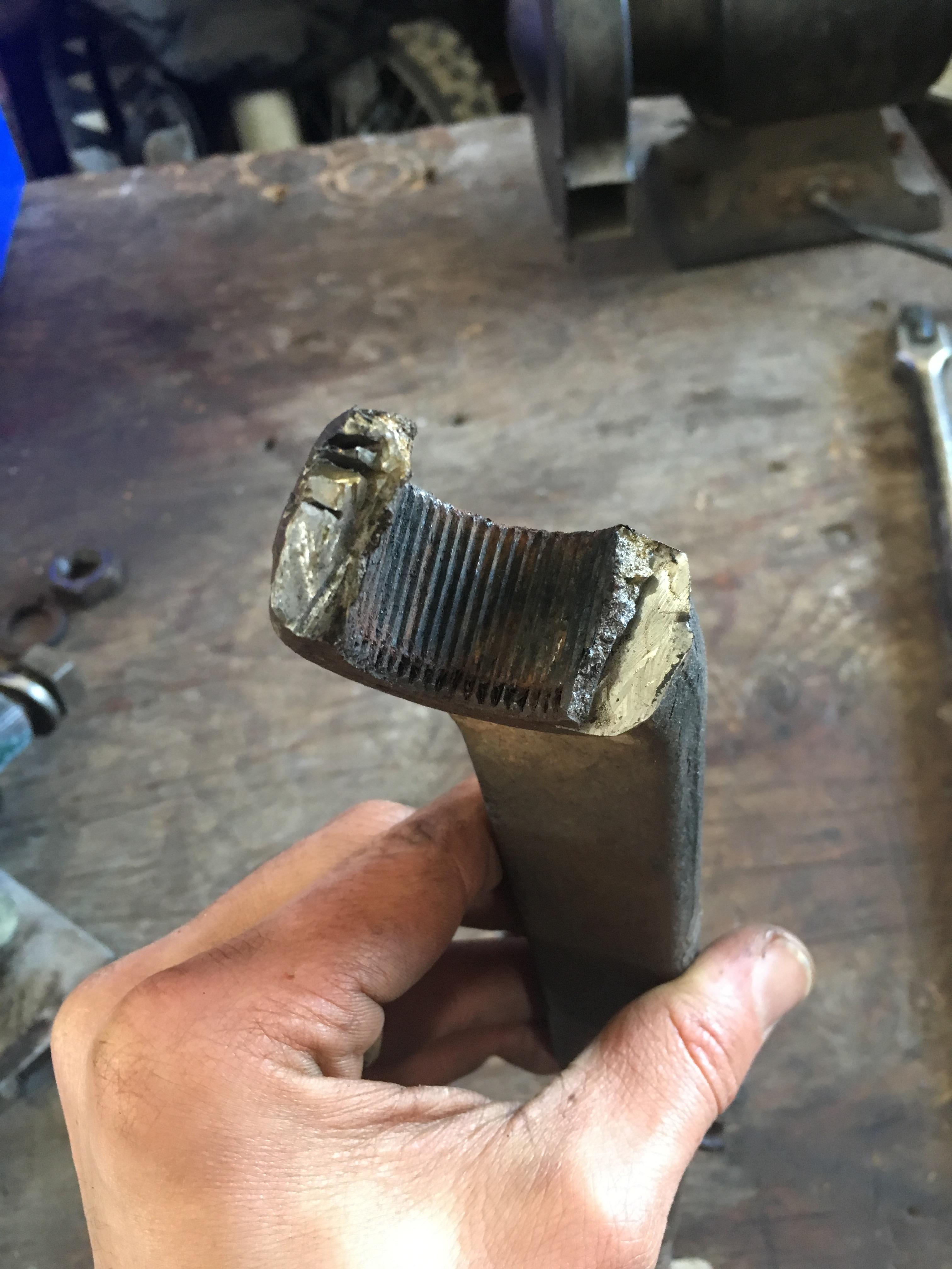

    Yea the gearbox shaft got a little ouchie, the old pitman arm got right effed up.  Cut-off disk, cold chisel, bfh. Easy enough eh.

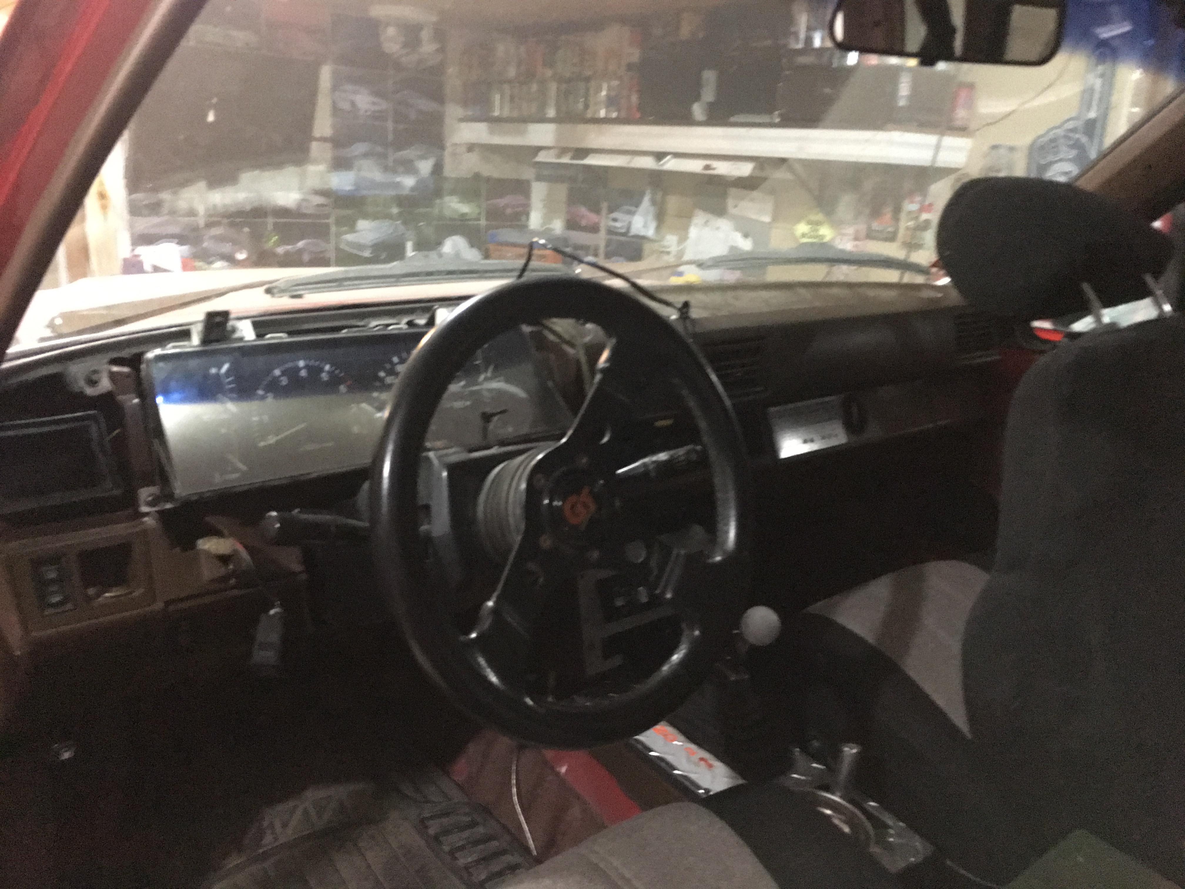

    I installed the 4” round speakers I got for chritmas into the original location in the lower dash.  I haven’t tested them, but I know it’ll be better than only rear speakers.  I have tube doors and half doors, so I can change as I please and not lose the tunes.

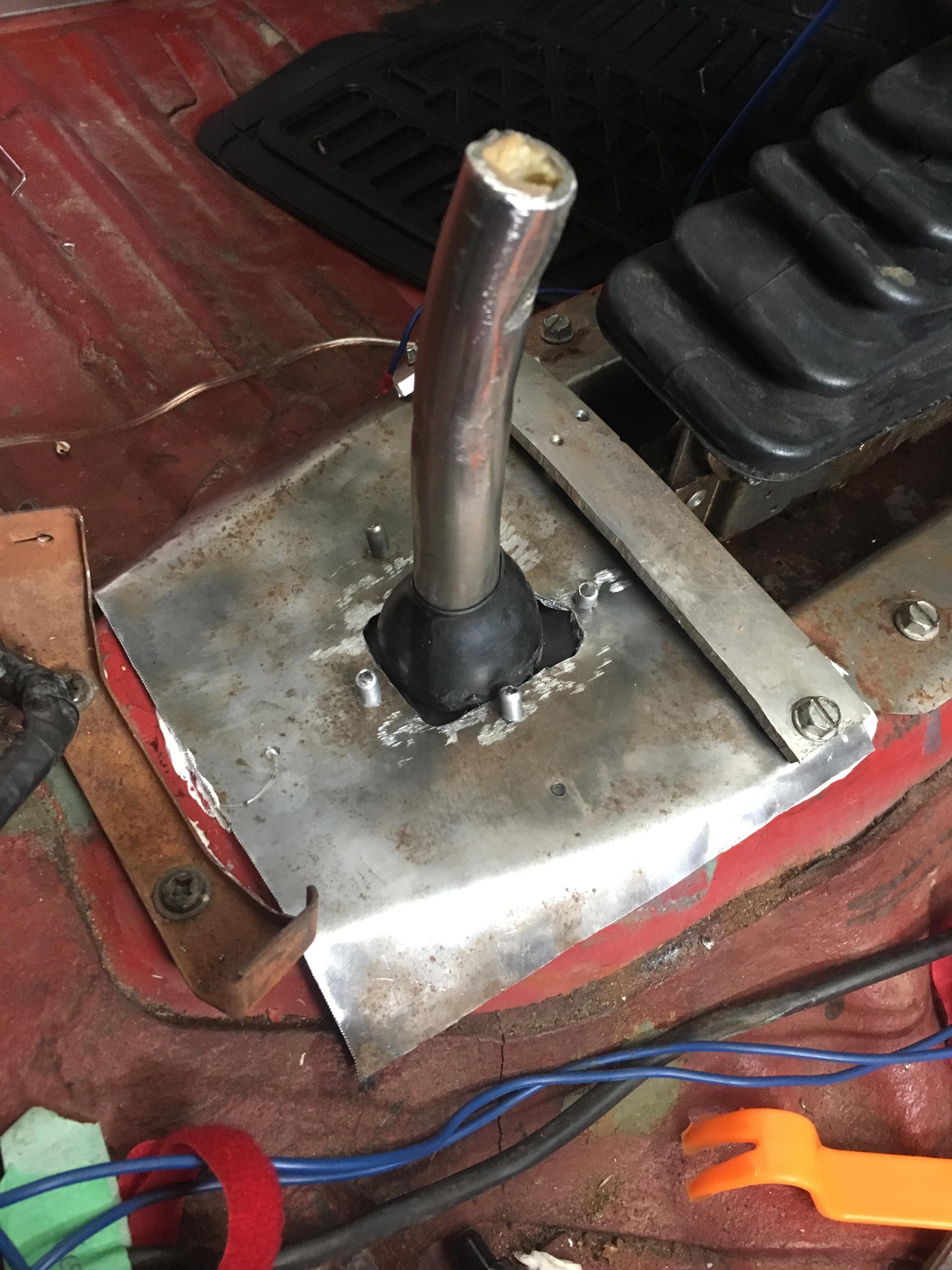

    I rigged up a boot for the t-case shifter through the floor. I used a toilet flapper and some rivets to get a flexible seal. Not pretty, but neither is the patch plate. Not worried about a pretty floor.
    Afterwards I installed the shifter surround housing the window switches, and bolted the seats back in.  Also put the gauges back in.  I’ve left the trim off so I can reach the tachometer adjuster screw and dial it in.  Very excited for the new gauge suite.
