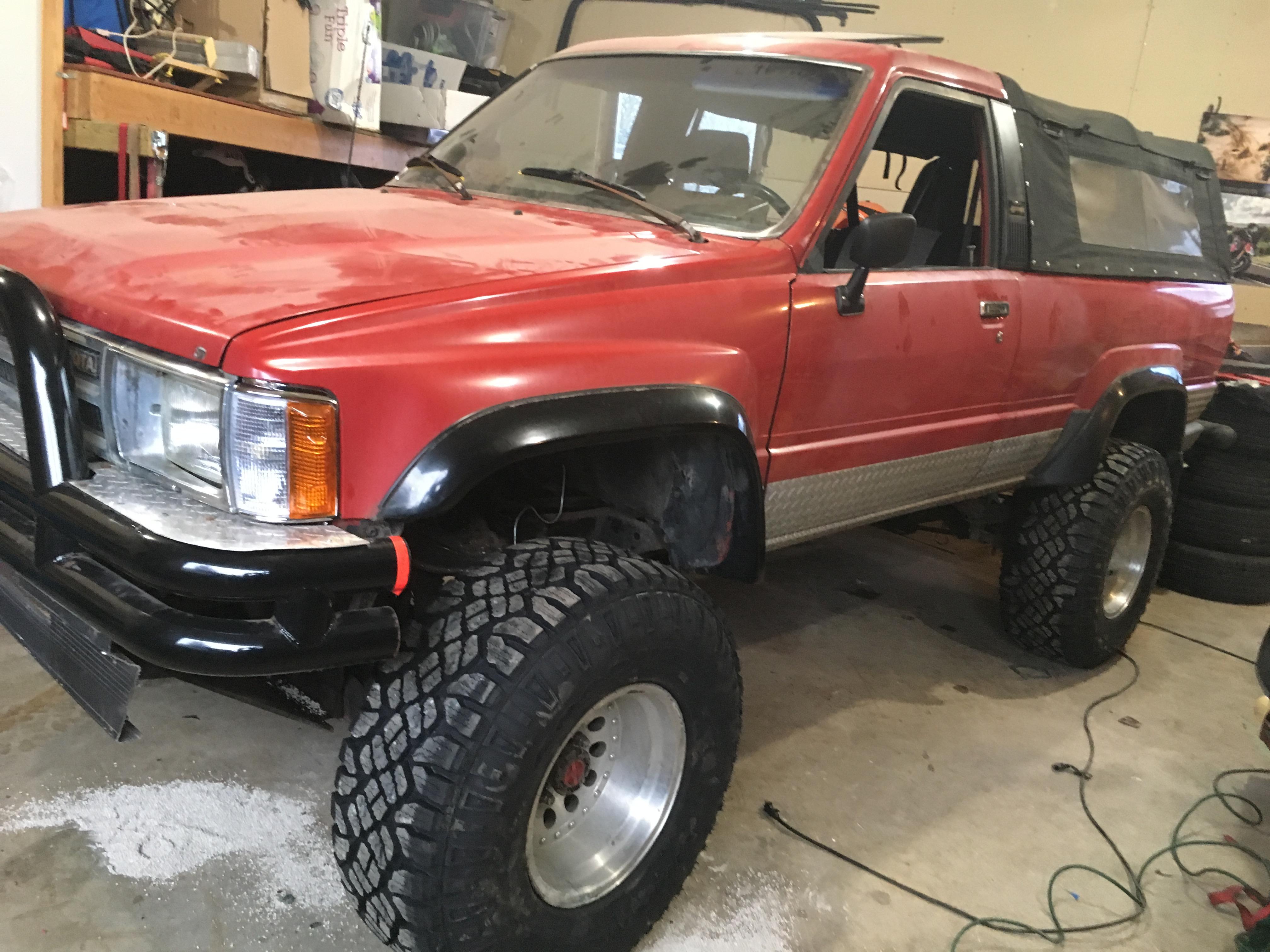

    Well I got Redee out for the first time this year! Took my youngest hunny for a ride around the block, she loved it.
    Unfortunately there’s a big ole’ coolant puddle under Redee, and until 3 mins ago I was unable to source the leak. Turns out it’s a heater core supply hose bypass loop thingy or what not. It’s right at the red tape in the photo. Easy fix hopefully, gonna cut an inch off and reattach it. However I must let things cool, just have myself a good ouchie leaning on the rad, D’oh!
    Oh yea, the bumper turned out great, and $100 of powder coat made it even better. Got my turn signals wired in, but said F-it to pod lights for now. Just wanna drive!!

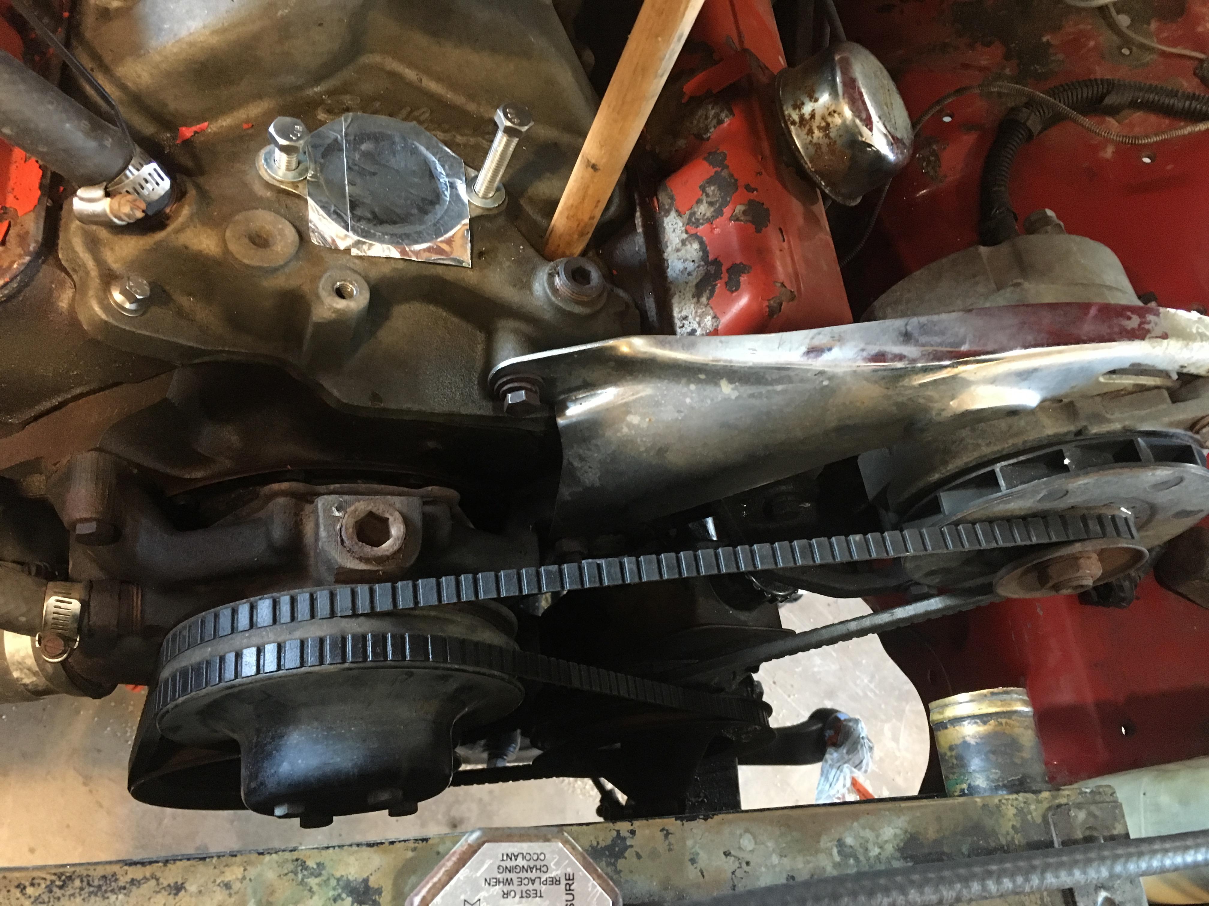

    Got the new V-belts put on, all my steering hard parts torqued to spec, zerks greased and cotter pins in place.

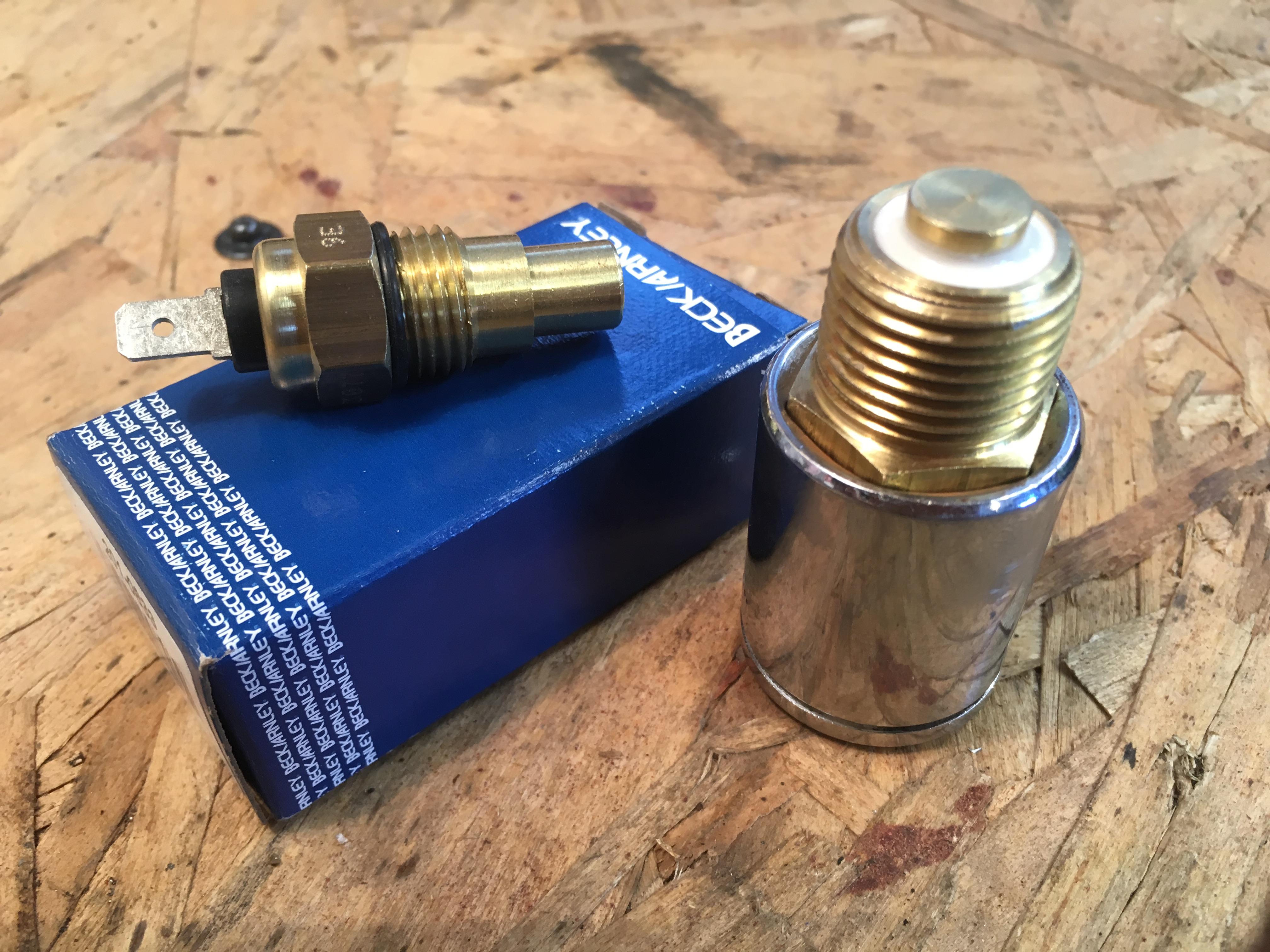

    Got my rigged adaptor getting it’s second dose of thread sealant. Initially I coated the threads like crazy, and threaded them together real tight, today I back filled a bunch of the open space between the sensor OD and adaptor ID.  I’ll let them cure a couple days before I install it in the block.
    I ordered a second sender that I’ll assemble with the homemade adaptor when my tap arrives in the mail. There may be a very small market for this chevy swap conversion piece….or I may be about 15-years too late.

    In my downtime from some chores around the house, I managed to get the V-belts installed (quite a chore in itself), set final torque on all the steering bits, grease all the zerks and install cotter pins.
    I feel confident the thread sealant will hold, now that I’ve got a second coat applied from the inside.  It’ll take quite a lot of pressure to force coolant past the sender.  Regardless I’ve bought a second sender ($6) to keep in a tote for whatever calls for it first   Either a leak on this one, or an opportunity to sell some conversion parts.  I’ve got 19 spare resistors for the V6/V8 tachometer mod.

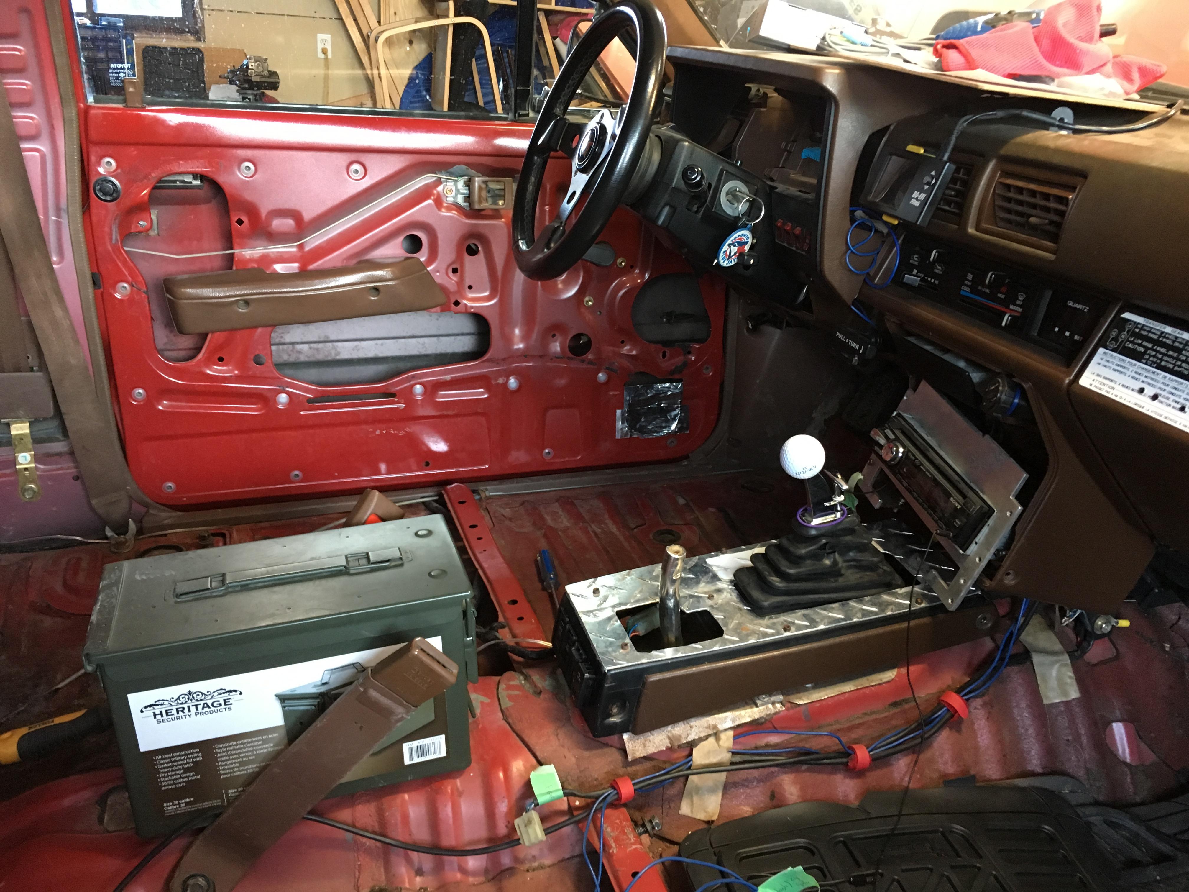

    Today I pulled the front seats out to make my next couple wiring jobs easier.

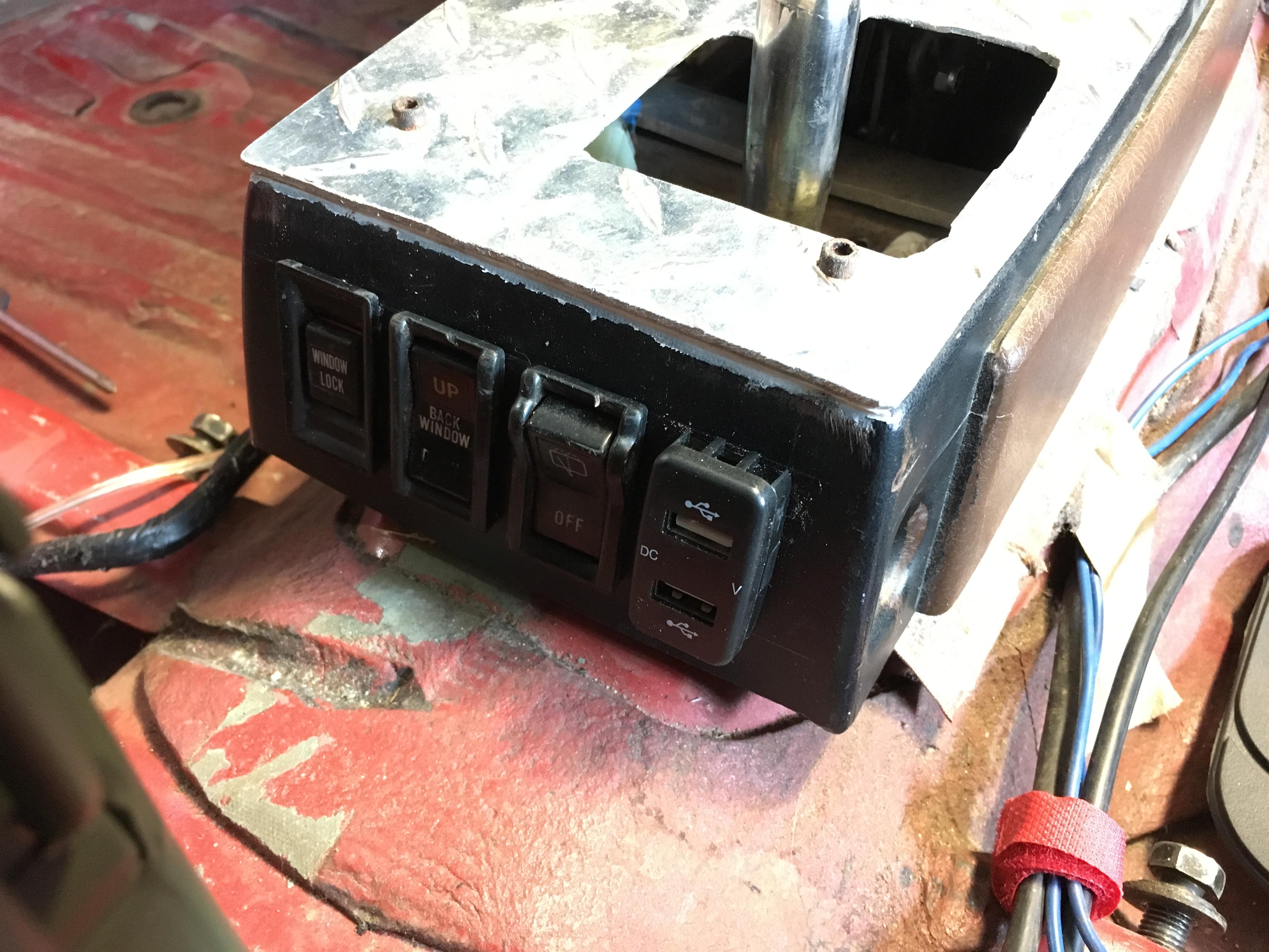

    I completed a relocation of the rear window switches, and added in a USB charger using the Cig Lighter circuit. I cut a few (more) holes into the transmission surround, and the 4 items fit very well. Best part, now the window Up/Down switch isn’t dangling and wedged under the driver seat, or getting tangled by the .50 cal lid and latch. May even have created space for a cupholder.
