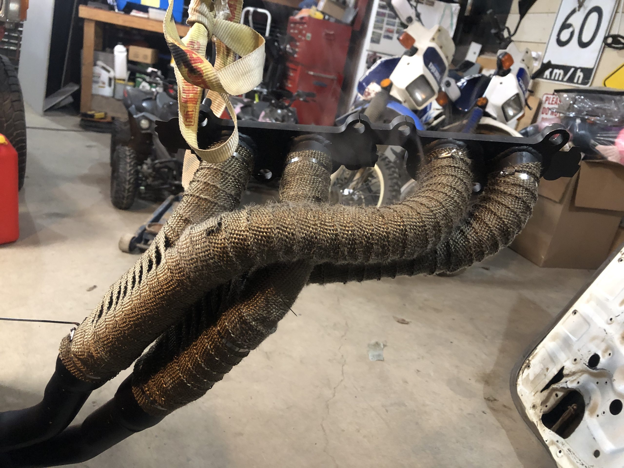

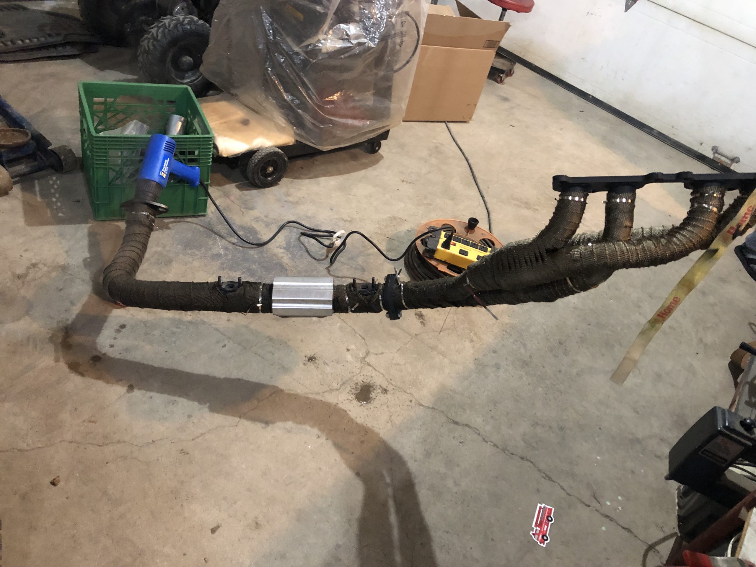

    Well I used up 95% of the Fiberglass wrap in my hoard of parts, waiting on ebay to deliver the last of what I need. I had enough to wrap 85% off the header, and lemme tell you that was a pain. I did manage to avoid the Fiberglass itch, so that’s yet another win.
    I’ll finish wrapping the last two pipes of the header, then the catalytic pipe when the last of the material arrives. Any day now really.

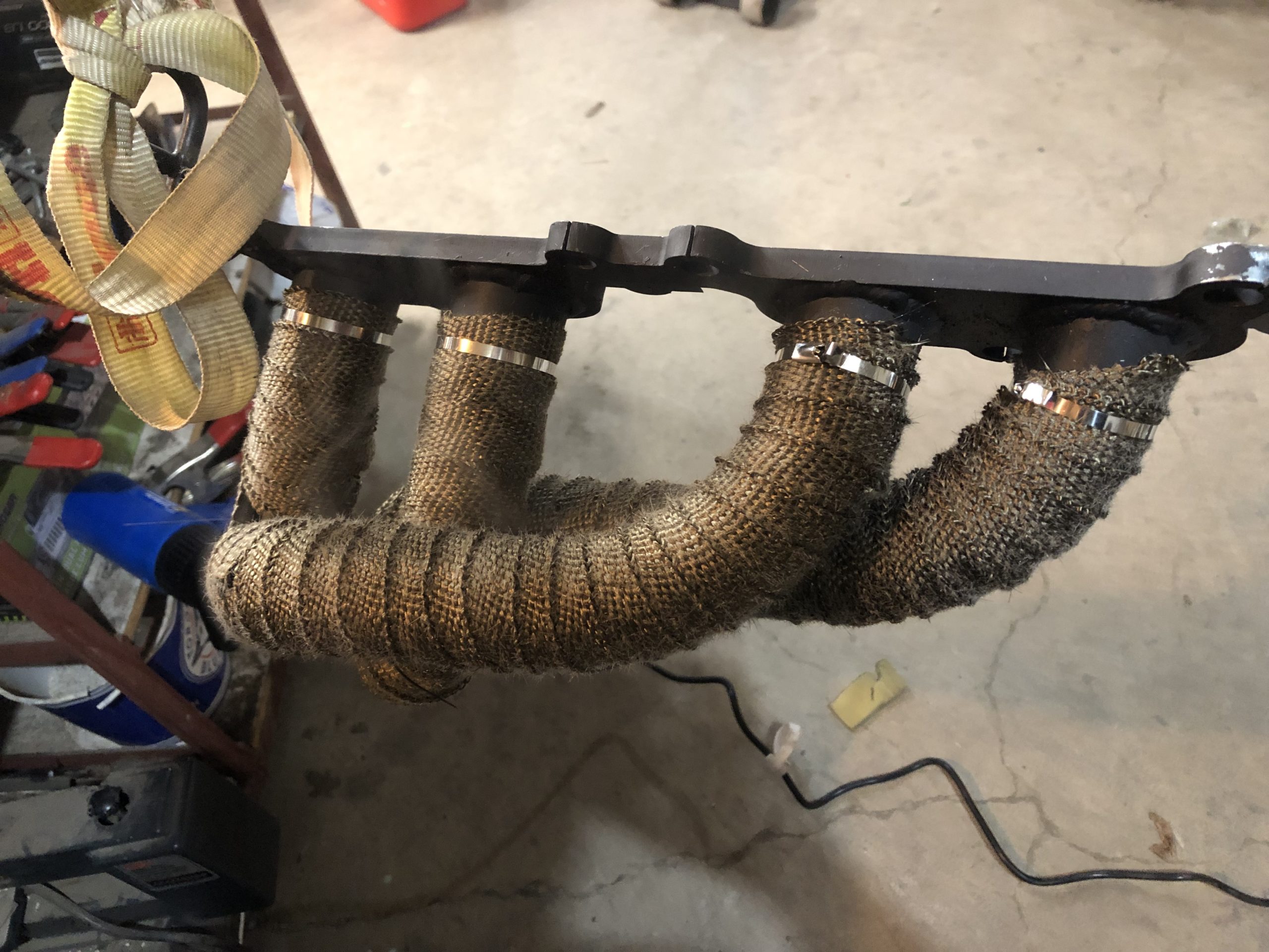

    Yesterday after dinner I checked my mailbox, to my surprise the last of my Fiberglass wrap was inside! So 10 mins after I tucked the kids in, it to the shop to finish wrapping the header and catalytic pipe. I’m not too happy with how the first 6″ of the catalytic pipe turned out, but it’ll never be seen by anybody but me (and you fine folks on the internet), so I’ve come to terms with said ugliness.
    Up next, more drying and then many coats of high temp silicone paint to seal it up.

    Welp, once again I underestimated the supplies I’d need, two cans of high temp paint were not enough. It didn’t spread nearly as far as I thought, barely got three coats laid using two cans. In hindsight, there’s a lot of surface area of all those individual fiber strands when you add it up. I ordered another two cans to arrive by Monday. Grrr.
    Last night I ran Redee in the shop with the full exhaust in place to help burn in, cure and dry the Fiberglass and bbq paint. Redee ran awesome with no engine lights, so the O2s are still working just fine. Had a lovely idle between 700-800 rpm, no strange noises, and the exhaust sounds good and is pretty tame at idle. I didn’t rev it at all, was midnight, and hardly any gas in the tank.

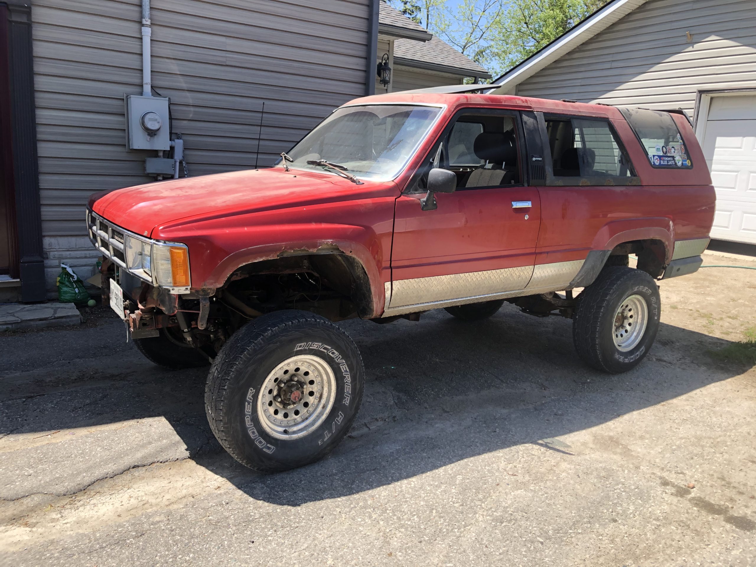

    Installed the rear drive shaft.
    Tacked the tailpipe into place.
    Fired the motor, let it get to temp to discover another coolant leak. Swapped out a tension clamp for a gear clamp.
    Added 40 psi to all of the leaking tires.
    Tour around the friggen block!!!!
    Clutch is chattery, assuming it’s just breaking in. Forgot how amazing the brakes were. The fan clutch won’t release, so at 2500rpm i get belt squeal. The cherry bomb is toooo loud.
    But this was a great first trip around the block.

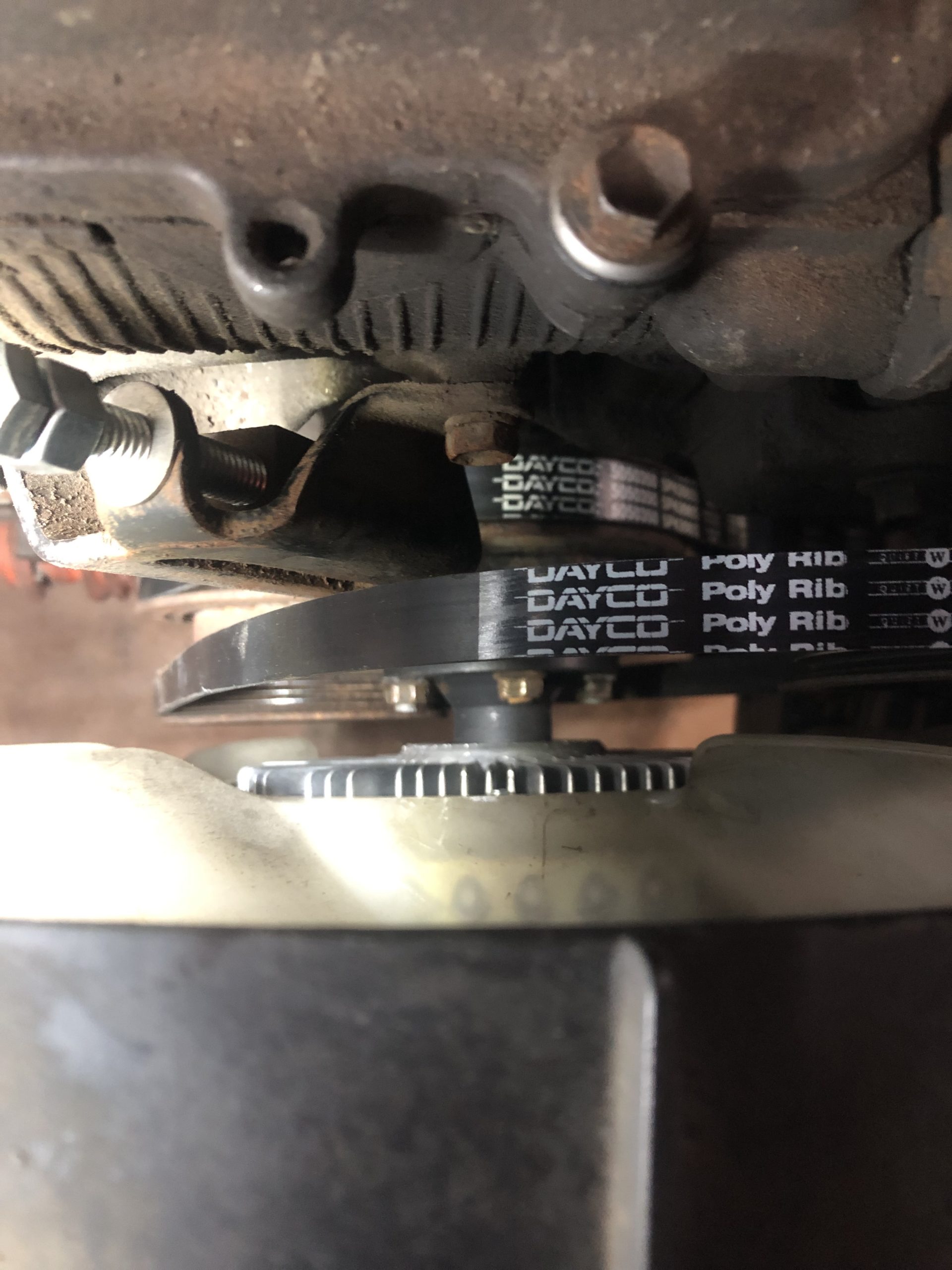

    Pulled the belts idler and fan last night to replace locally. After getting a quote, I bought my replacement parts on rockauto. Local shop only carried the premium brand parts, $39 belt vs $12 belt. $175 clutch vs $62 clutch.
    Seeing as Redee is not a DD, gonna save money on these parts where i can.
    Still on the hunt for used tires.
    #212401
    Got the new belts and fan clutch in, idler bearing didn’t arrive on time. That’s ok, hopefully it arrives tomorrow. I could re-use the old one, it’s in decent shape still, was gonna keep the belts and idler as trall spares.

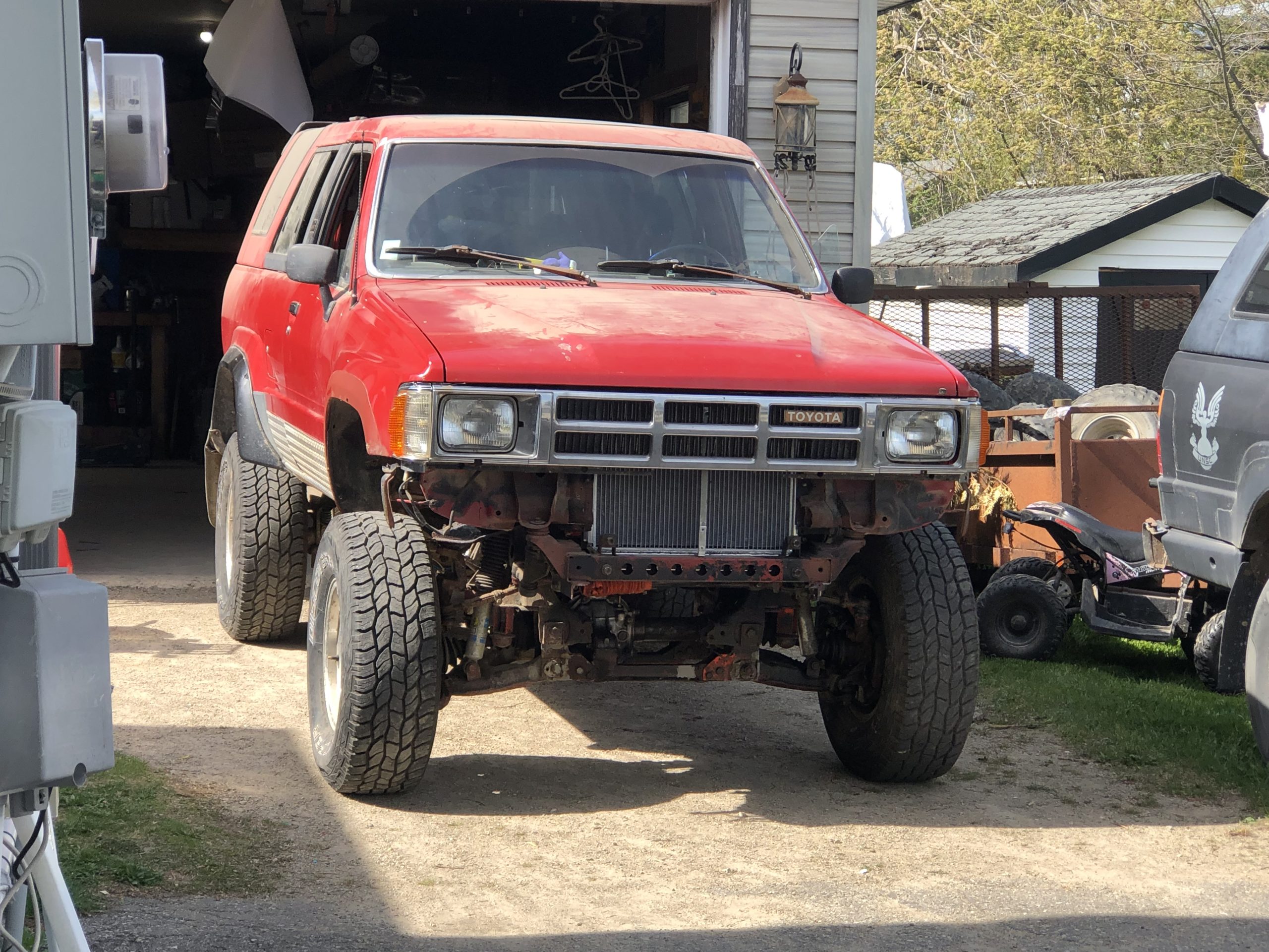

    Still gotta figure out something for front and rear bumpers. I don’t want to put the Smitty Bilt back in the front, the body mounts has to be cut and eventually failed (why I had to weld repair them). May start grabbing scrap metal from the local shop and sticking stuff together till I’m satisfied. Rear bumper had something home made that actually resembled the smitty bilt, but it was never properly mounted. I think it was originally built for a pickup, so needs the “Z-bracket” to lower it under the 4Runner tailgate.

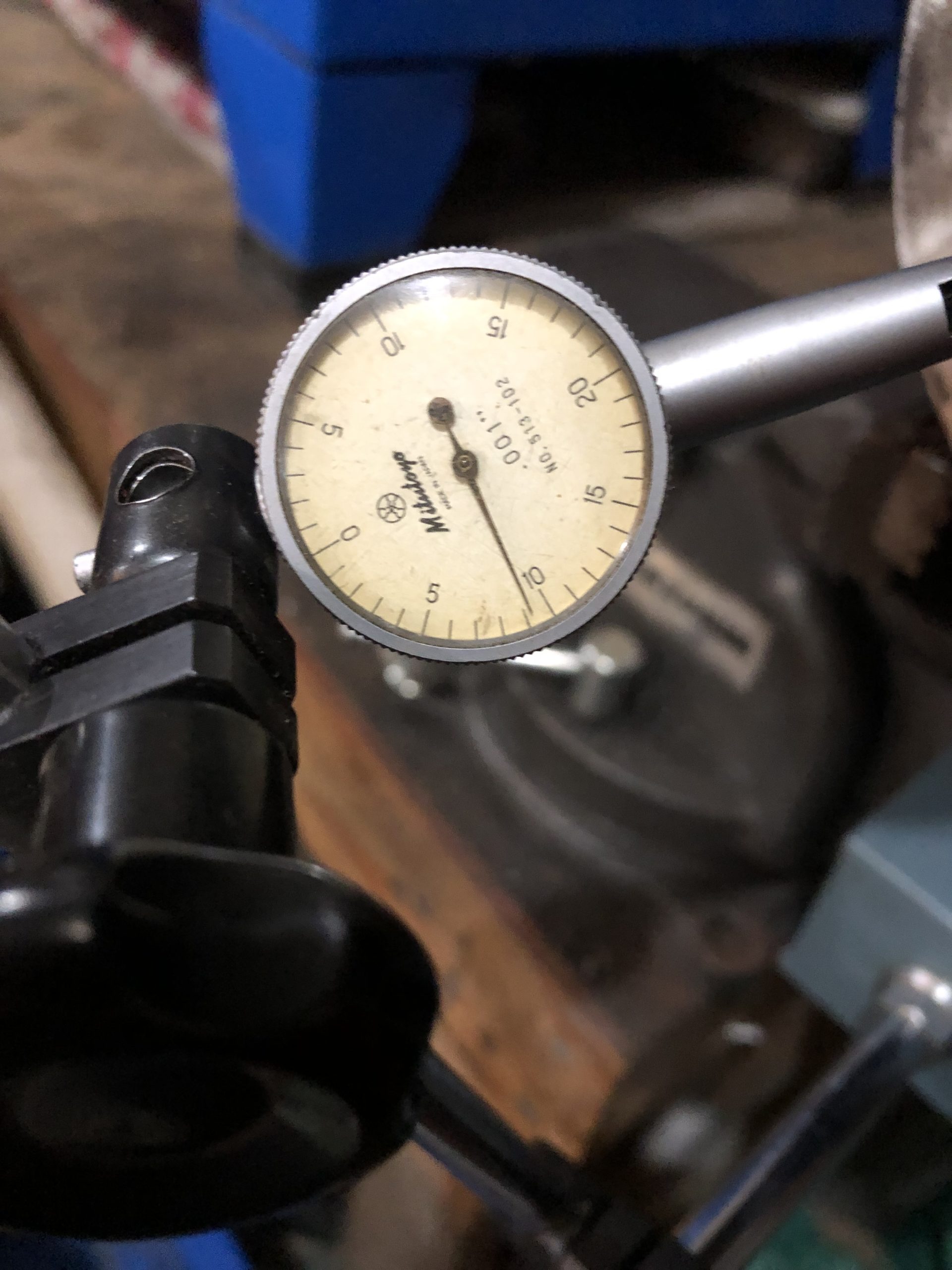

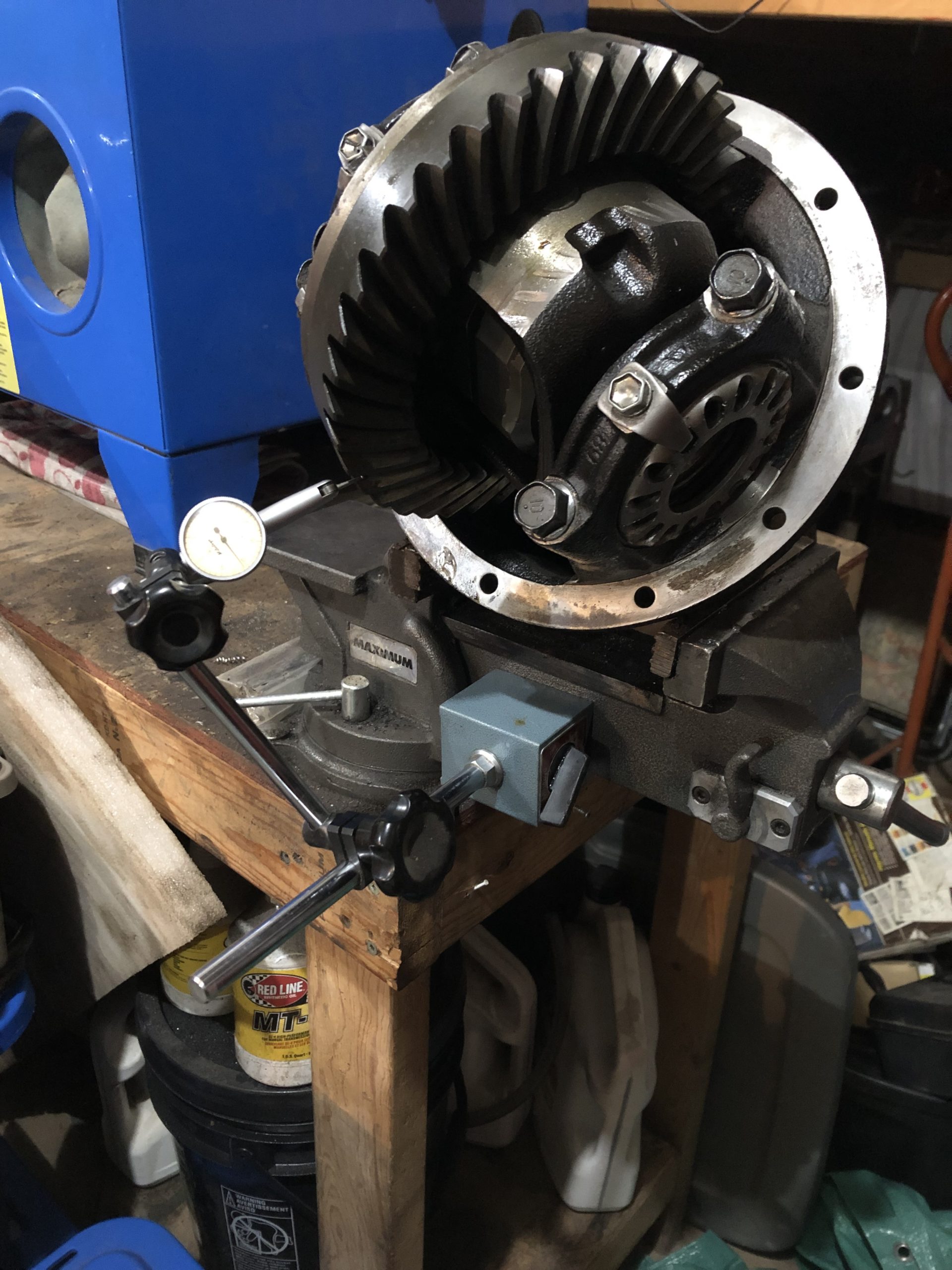

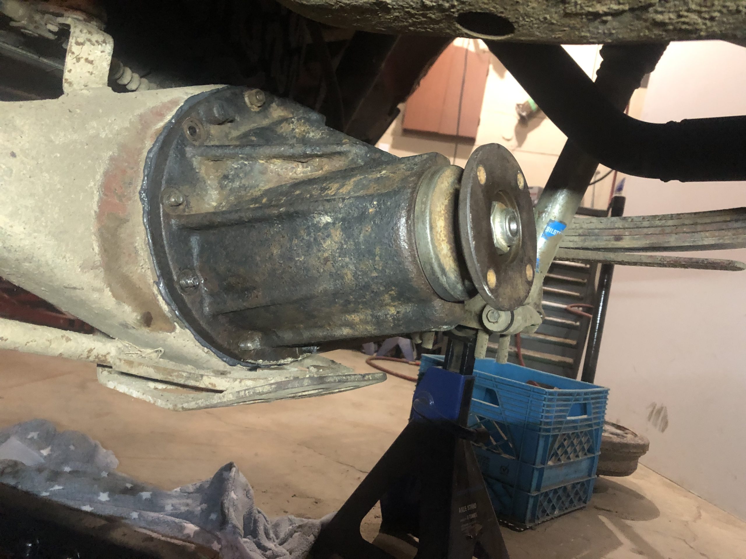

    Put the 4.88 diff into the vice and verified ring/pinion backlash to be 0.009″ which falls nicely in the 0.006″ – 0.010″ spec (i found online).
    Next up, do final torque on the bearing caps for that third member. I’m Considering swapping it in while I wait on tires to come in stock.

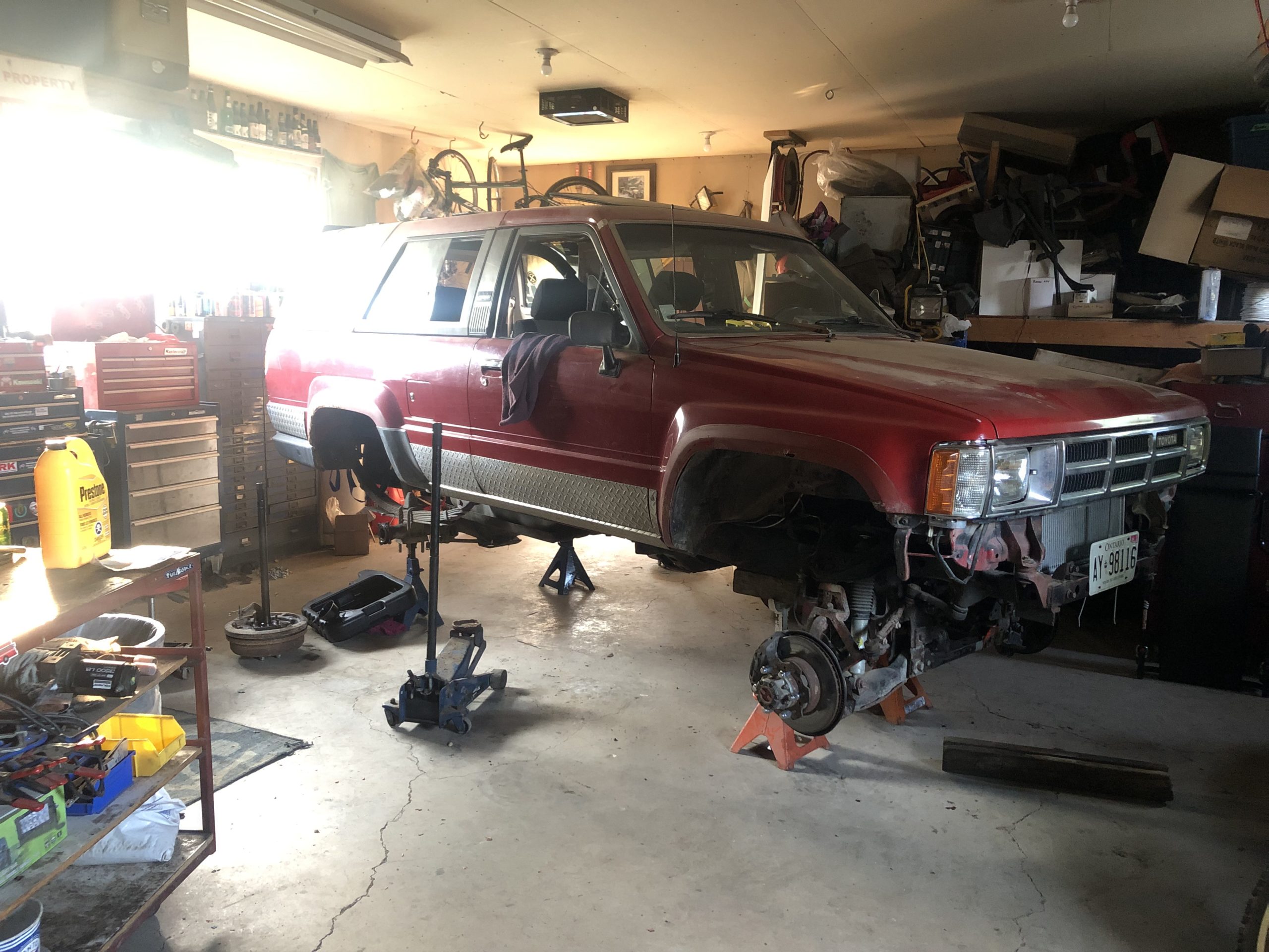

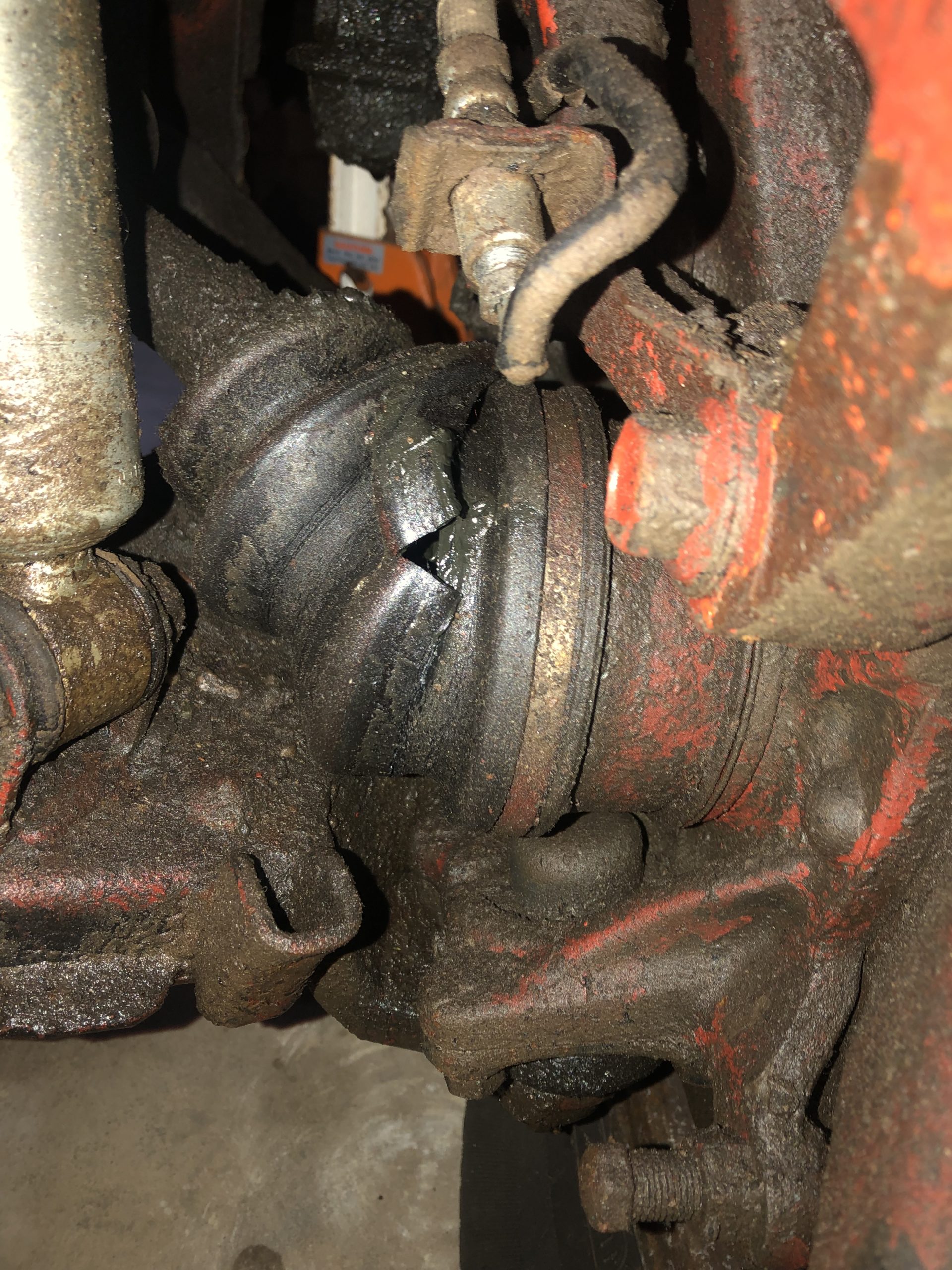

    Lucky me, I parked Redee and the CV shaft just so happened to be in the right orientation that i can see the outer boot is completely destroyed on the drivers side.
    So I gotta replace the inner and outer boots before touring season arrives.
    #212423

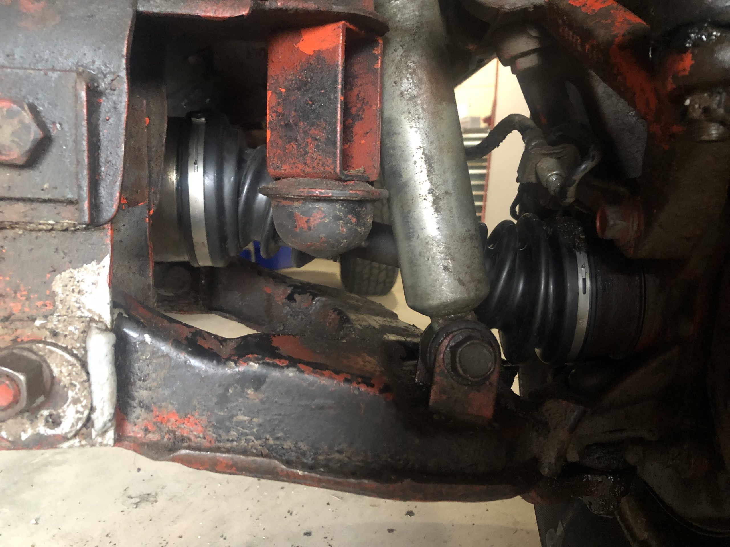

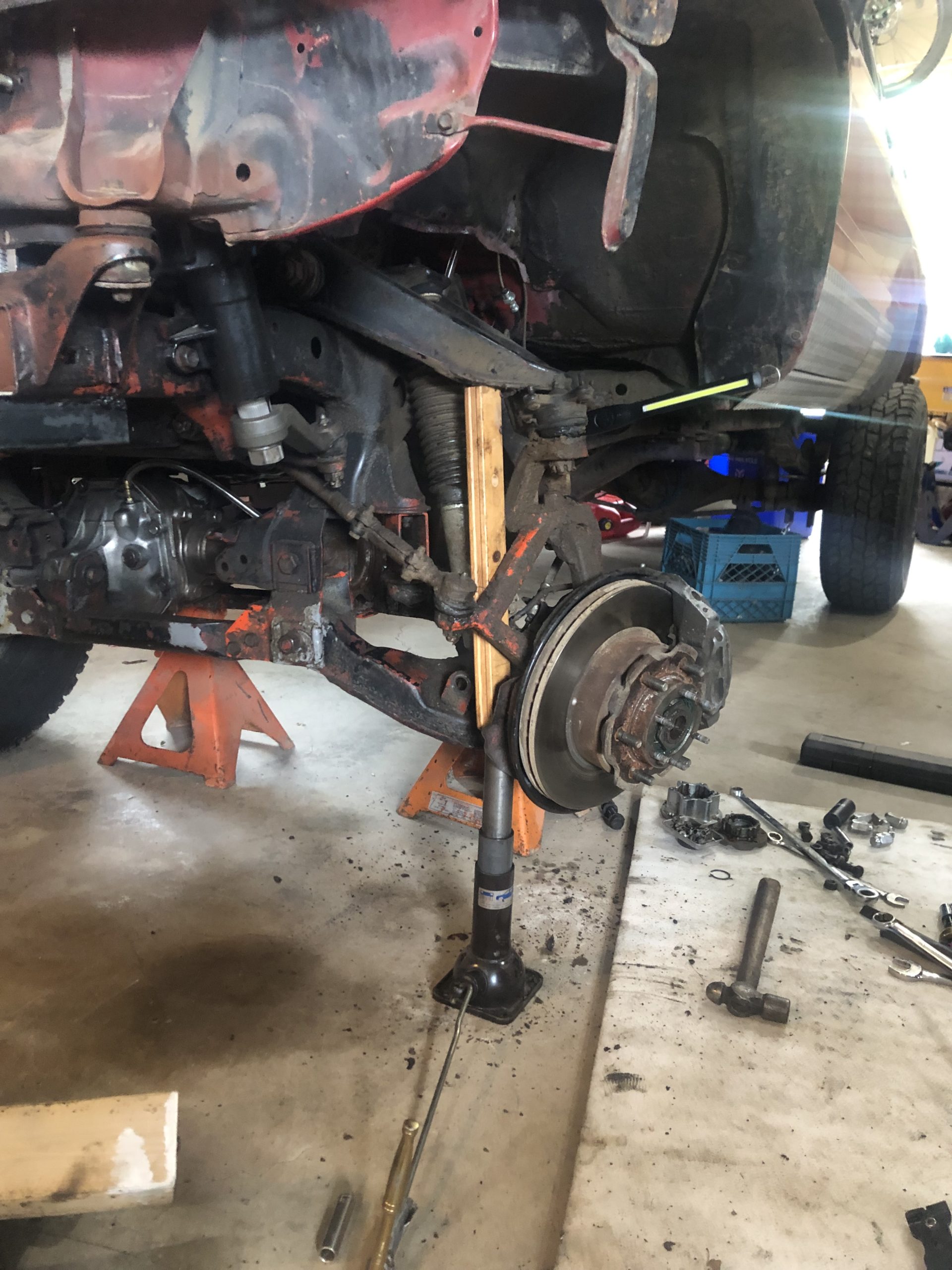

    Put a new set of boots onto the drivers side CV shaft. Passenger side still looks good, gonna leave it alone.
    Do you guys pull the upper or lower balljoint when doing a CV?
    I unbolted the upper from the control arm, but it’s a real pain in the ass to get it lined back up after. Anyways, job went smooth, glad it’s done, that corner was really really greasy.

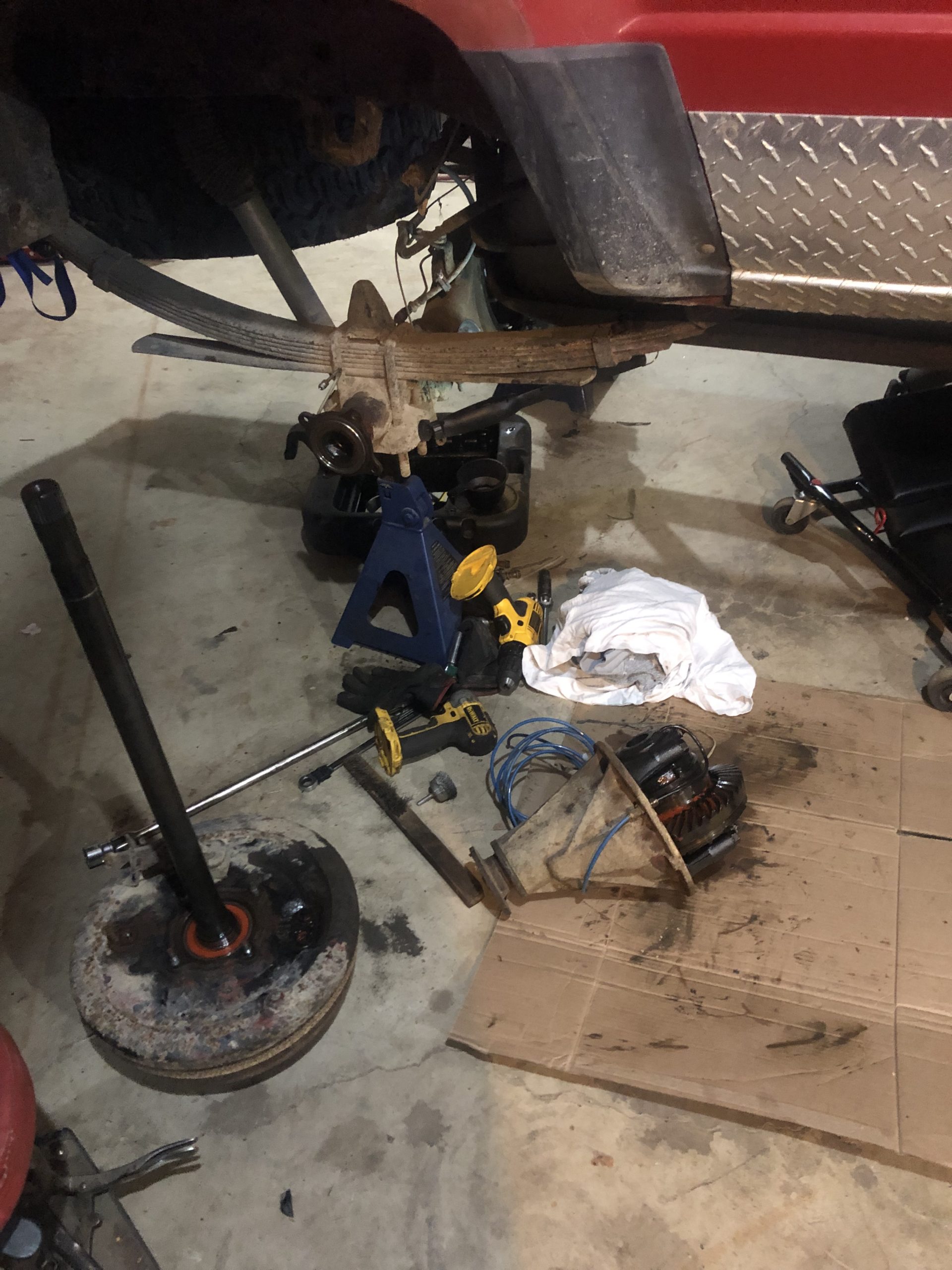

    Made slow but steady progress last two nights doing a third member swap, hopefully finish it up tonight and take a test drive.
    Out came the 4.10s with a leaky ARB (think it needs some O-rings), in went the 4.88 lunch box. Hopefully get some first hand experience with “the clicking” noise as the locker ratchets late tonight. We shall see.
