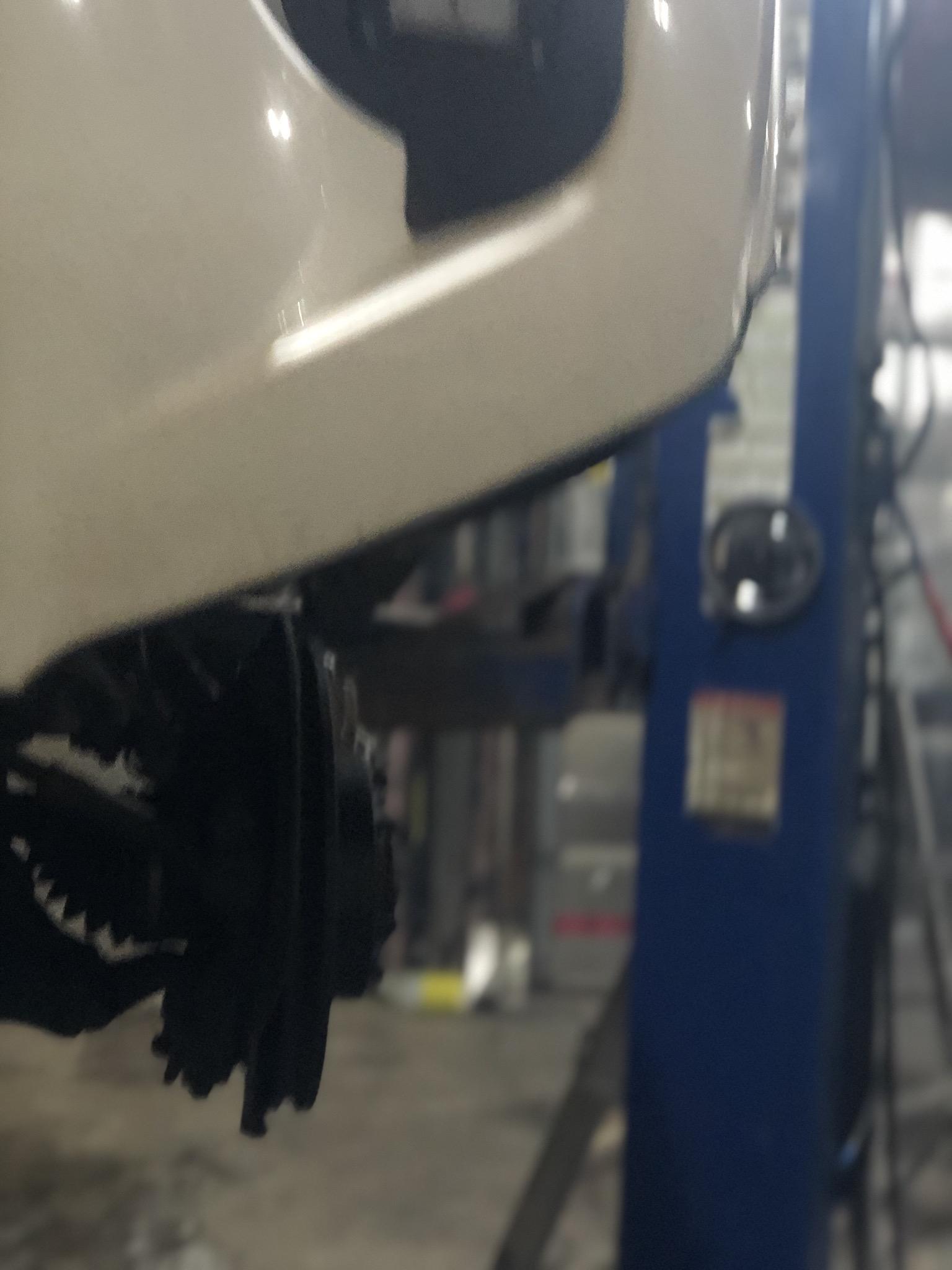

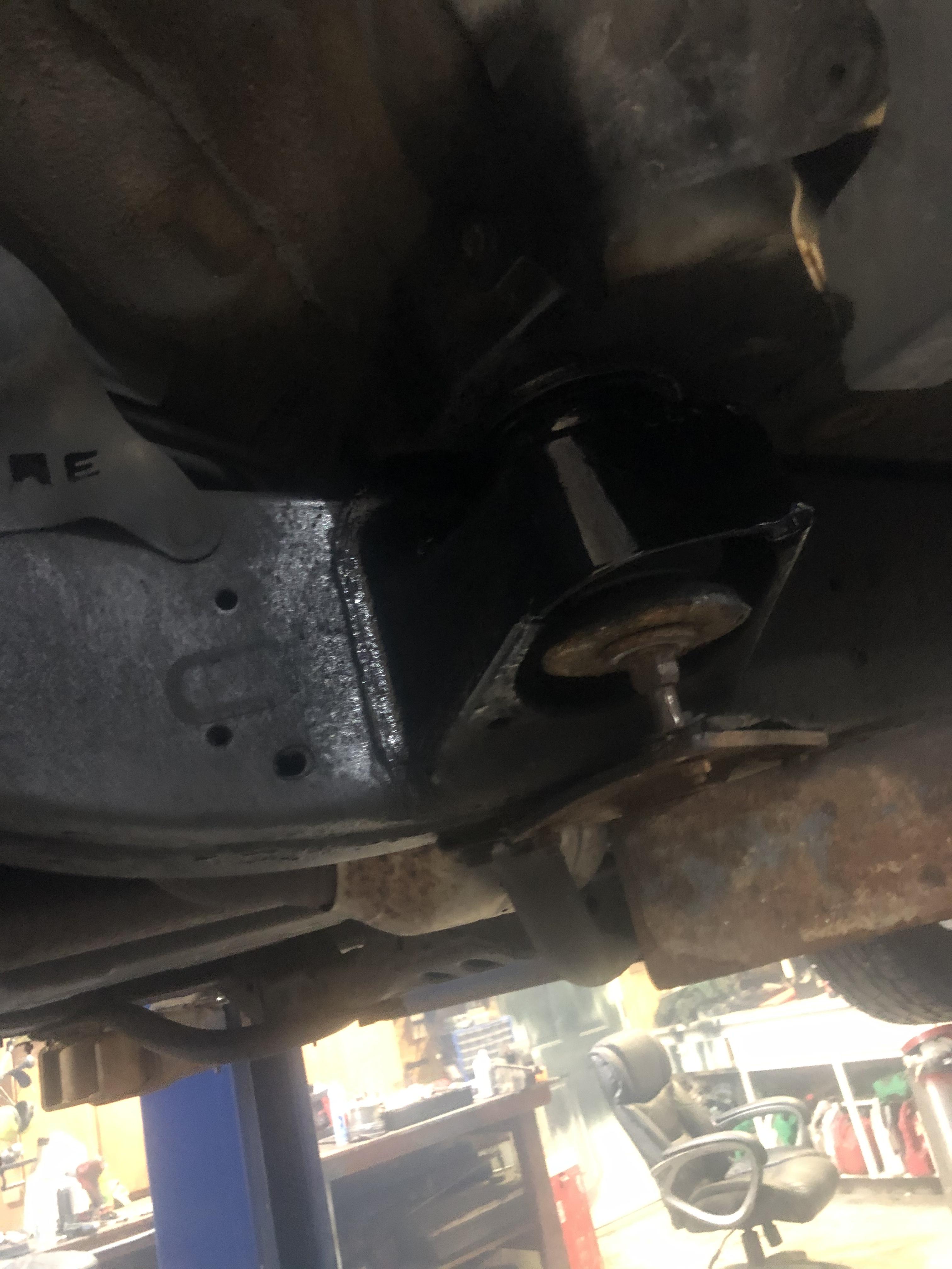

    Well the time has come where I want to get into some larger tires. Time to give the 4Runner a cut or two. Did a stage one bumper cut and had a good friend help with a bmc

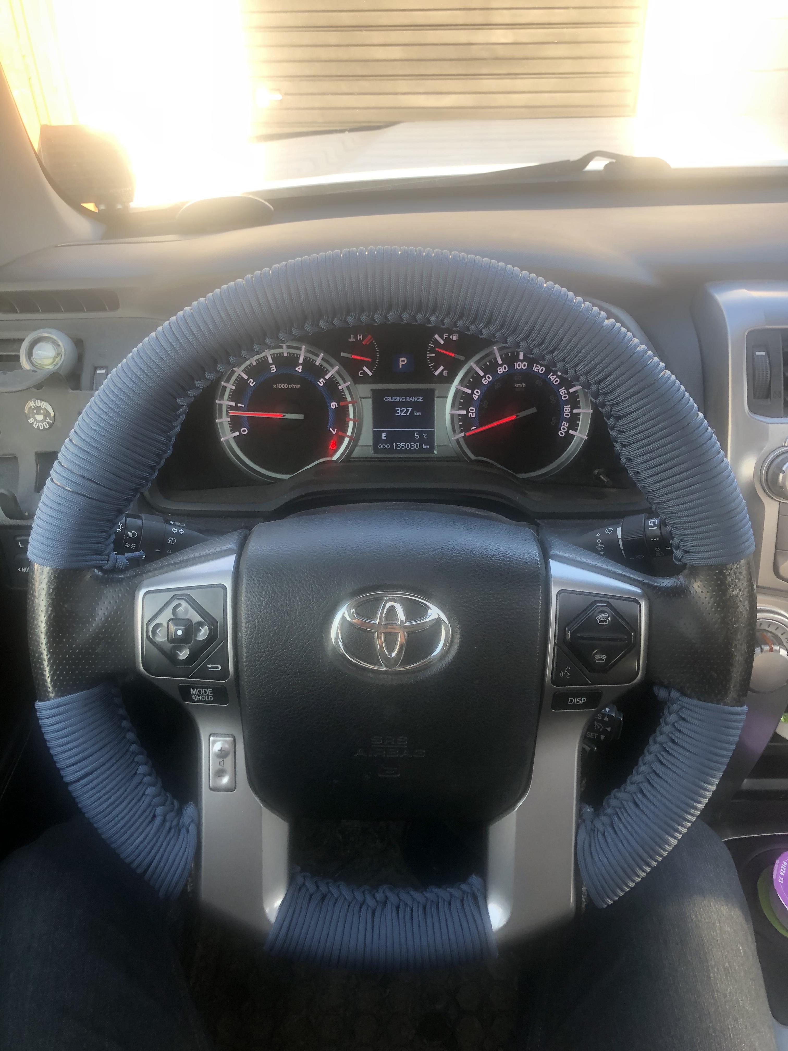

    With the nice weather this weekend and a boat load of paracord I wrapped my wheel because it was starting to show it’s wear

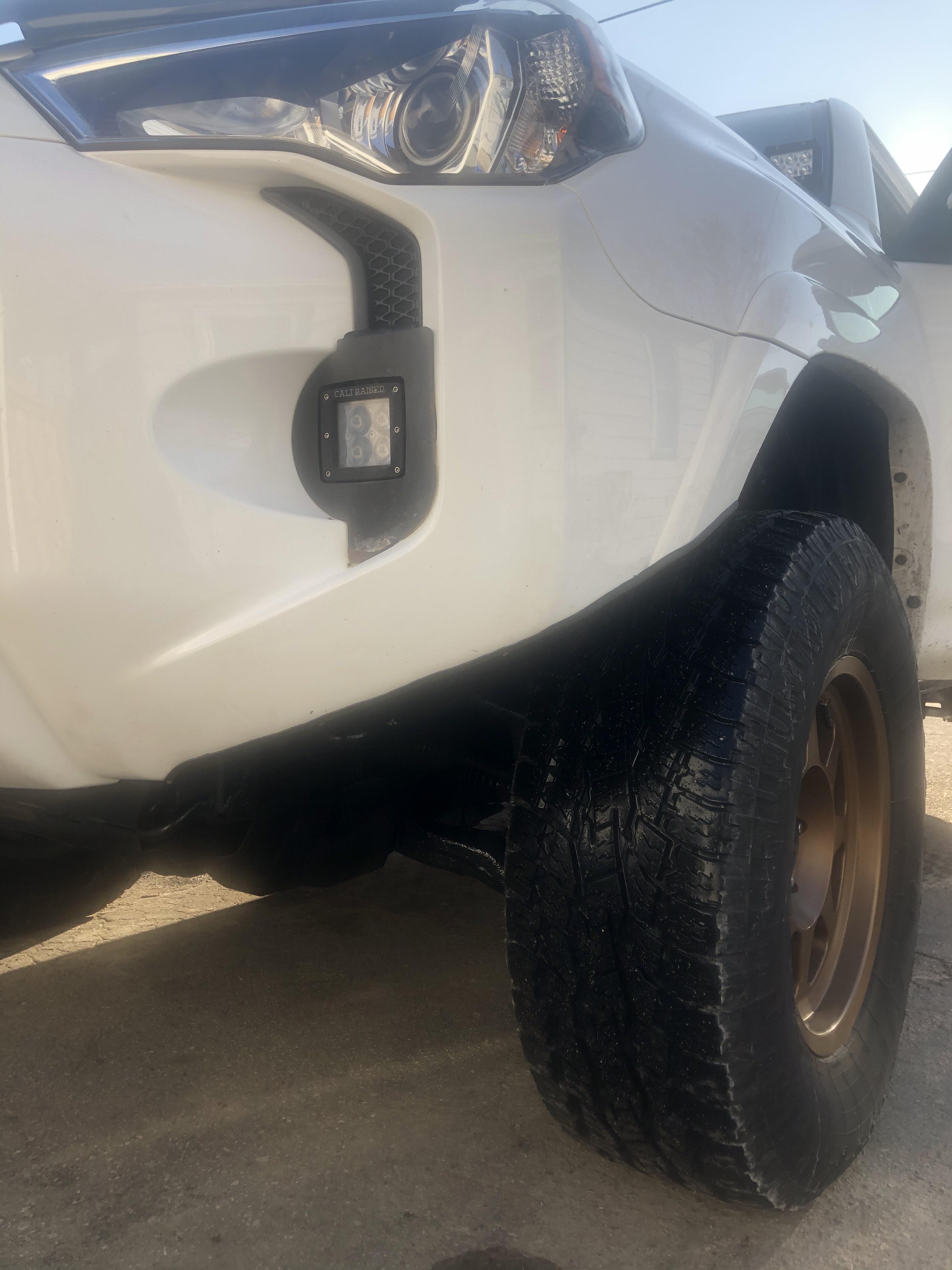

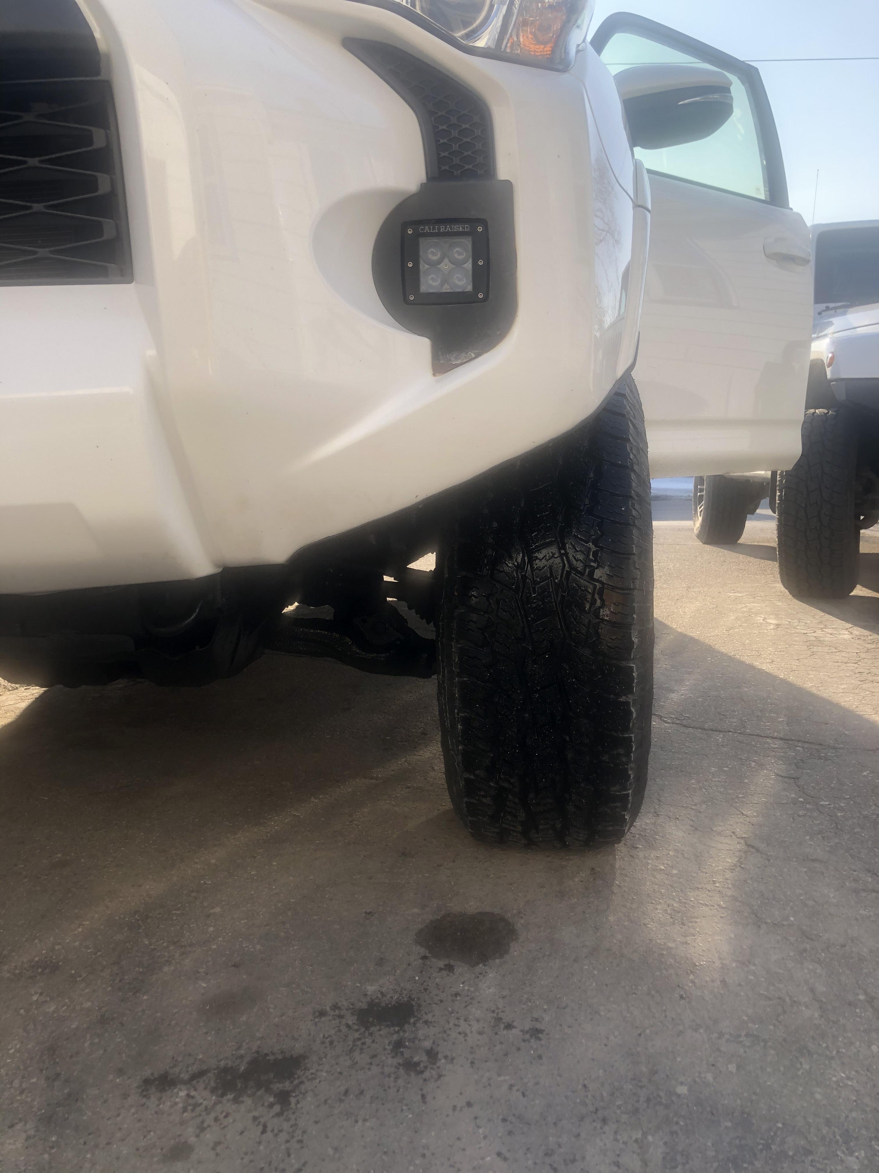

    Benlamers
    I started with cutting my front plastic bumper and reshaping my inner fender liner to contour to the new shape. I then trimmed it out with 3m vehicle trim. I went with a less aggressive cut to still provide rigidity using the lower contour as a starting point. I then measured 6.5 inches down from the top of the bumper(where it meats the fender) 4.25 inches beneath the fog light contour and 2.5 inches in from the middle portion of the bumper.
