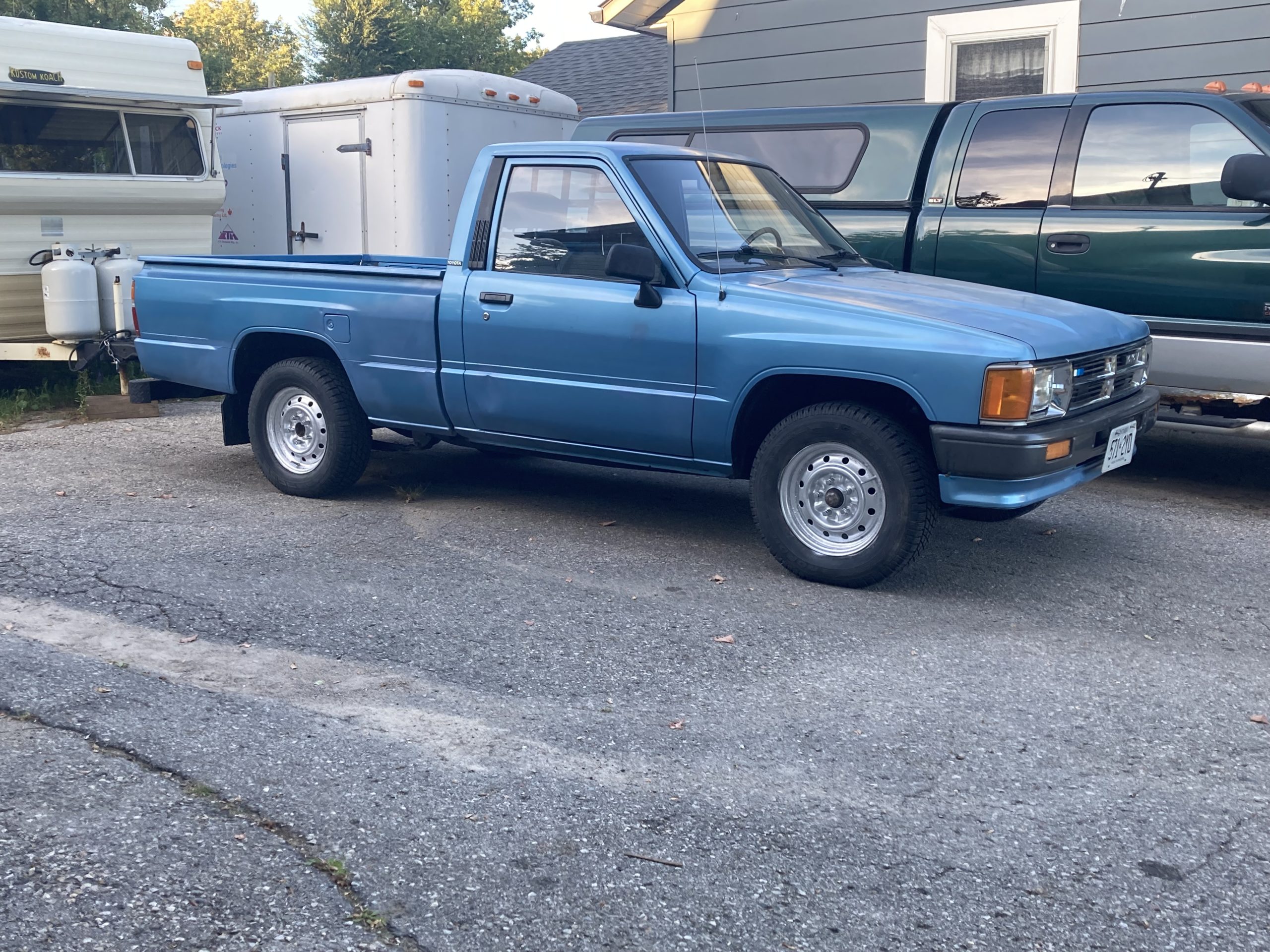

    The shop has seen some action over the weekend, mainly with Matts pickup.
    On Saturday we drive to Elora to pick it up from a Buddy who welded in a drivers floor, did a great job.
    Saturday when we got back, dove back into repairs and troubleshooting. Trying to solve a high yet weak idle. If we adjust idle below 1,200 rpm she dies.
    The truck starts strong, but as it warms up the idle speed increases.
    Anyways, Saturday we replaced the ignition coil, set the timing to spec as per the service manual, adjusted the valves into spec, and tensioned the engine belts. None of that helped the idle, however the engine picked up that healthy 22R valvetrain tapping noise.
    Next I’ll check compression on all 4 cylinders. Maybe one of the top rings got fucked over from being rusted to the cylinder wall for a couple years.
    Sunday we made big efforts to increase comfort. Throughout the day I managed to swap over the bench seat to a 89-95 sliding split bench. Had to drill new holes in the floor and crossmember, weld up a rotten foot too. Was all with it. Sooo much better with some lumbar support and being able to recline a little. Matt is super thrilled. He bought this bench seat outta PEI, had a Buddy drive it to Ottawa when he moved, then a third party kijiji guy (Sean, real legend) whom I bought parts off of, met up in Ottawa and brought the seat to Midland, where I met him.
    Pickup needs those steering parts, rad hoses and the carpet put back in.

    Last night in The Shop, I did just that. On Matt’s’87, I replaced most of the steering components in one go. Previously I had put in a new idler arm, but last night the truck got a new drag link, inner & outer tie rods and sleeves. The only old parts in the system are the steering stabilizer and power steering gearbox.
    Tonight I’m gonna do some reading in regards to said old gearbox. If I recall correctly, it can be adjusted to take up some freeplay, which is what i hope to achieve.
    When Matt gets back in town we will use a string to set toe-in on the front alignment, just a touch so he can get to a proper alignment shop.
    Hopefully also tonight I’ll tackle a massive exhaust leak. Sounds like a hanger tore a hole in the rust pipe we are calling an exhaust. But I’ll know for sure after the sawzall makes an appearance.

    A couple more tweaks on the mini truck, pretty confident she’s ready to face the criticizing eye of Mr Safety Inspector. We re-set the rear wheels on the axle (lug centric steelies a pain), pulled the seats out to install the factory carpet, and cleaned all the glass again.
    Matt has an appointment for safety and alignment tomorrow.
    Insurance has been paid for the year.
    24-hours from now we OUGHT to be cruising…fingers crossed I’ve dotted and crossed my consonants appropriately.
    Sunday night we also pulled the spark plugs for inspection, and compression tested the engine at 155psi in all 4 cylinders when cold. I’m convinced the idle problem is still a vacuum leak. After all the paperwork is sorted out, we will dig back in looking for vacuum leaks. Matt picking up brand new metric vacuum hose from VW today for whenever we get motivated to get started.
    The truck cold starts perfectly, but as it warms up the idle speed comes up a little bit, becomes unstable with an audible misfire, and seems weak (for lack of better term). My theory is that we have set the idle to 1,300ish rpm, but the air leak is giving us unmetered air, to the tune of roughly 500rpm. Solve the leak, set rpm will drop too low, fine tune the air/fuel idle mixture and idle speed. As it sits, the air/fuel idle screw is pretty much useless, bears no effect on current idle speed.

    Also on Friday I started on Matt’s mini truck, by tensioning the V-belts and replacing the drum &shoe on one side. Saturday I put in the other shoe & drum, repaired the washer pump by clearing out some goopy shit. Also changed a headlight. Today I changed a trans mount, had to drill out a broken bolt which took a long time. Anyways, waiting on cab mounts to arrive, then I can swap those in and be done with the mini for a while. Over the weekend we also tuned the carb and timing a little, seems to be running a little better.
    #212620
    Last night in The Shop, great feats of collaborative efforts yielded great results. Matt and I changed the body mounts. Old ones were pretty pooched, will have to un-stack trucks to take it for a test drive.
    Later today Matt is coming back with his stock tires so we can swap them over. That will satisfy the last outstanding repair item from the inspection.
    Matt plans to drop the the truck for safety Monday morning.

    The Mini is finally road legal! Stop the clock! Passed inspection today, Matt already in line for new plates at Service Ontario.
    When I get home we’re gonna put the wide wheels back on, and go RIP on this truck. Get the last of the carbon and cobwebs dislodged.
