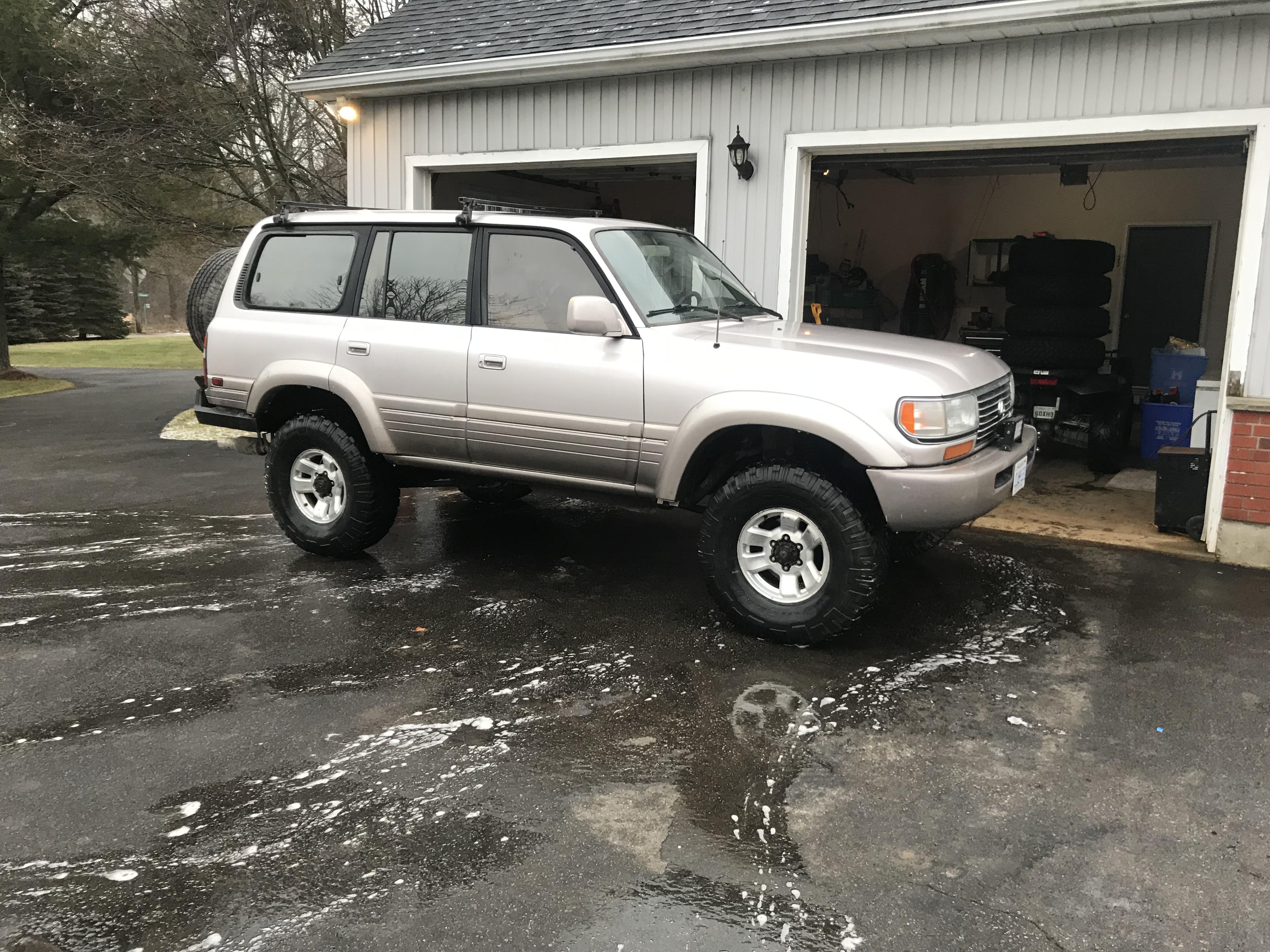

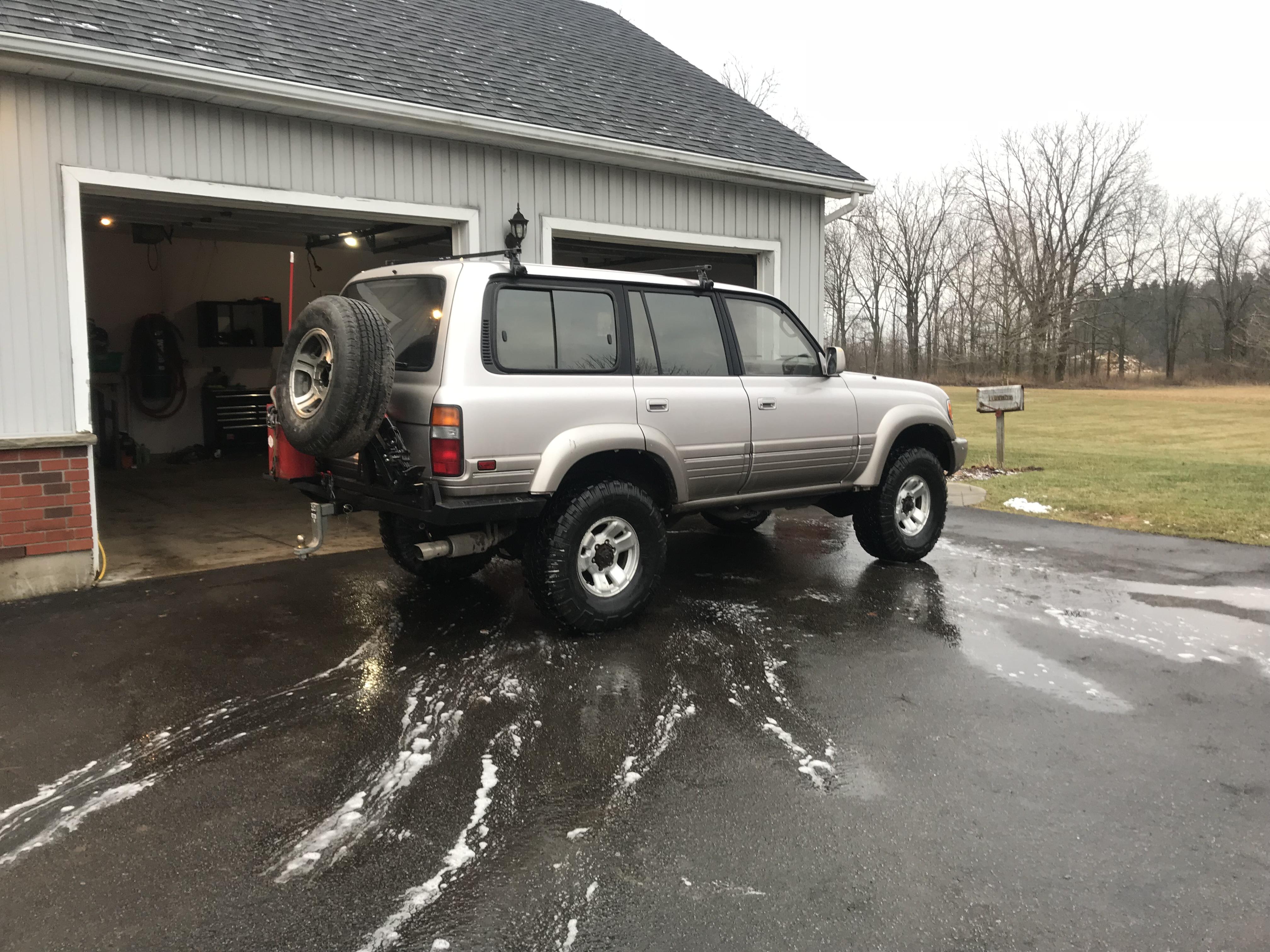

    1. Took like 15 hours but so happy it’s done. I replaced wheelbearings and all races, trunnion bearings, one broken wheels stud and all the wipers and seals. I wasn’t too happy about the wheelbearing preload I just couldn’t seem to get it right but hopefully it works itself in.

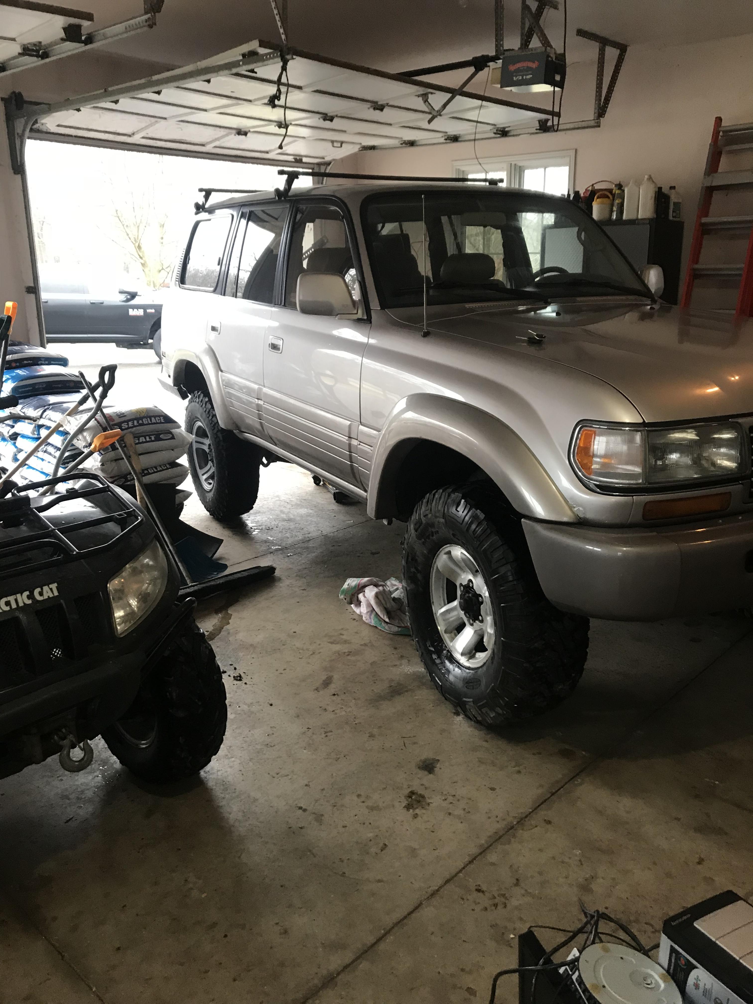

    Toy-Yota
    35s bolted up

    #208817

    Ugggghhhh I know your pain. I find the trouble comes up when putting pictures and text together…hit submit it shows as there, change page and it’s gone.
    Notice any driveability changes since the rebuild?
    When I did the preload for IFS , I just cautioned towards the tight side of tolerance, assuming it’d loosen up under abuse.
    #208821
    Toy-Yota
    1) my problem with posting has been the exact same!
    2) driveability I don’t really notice much change, aside from the tires being loud and a lot of sidewalk flex, I think I need an alignment too.
    3) I did the same thing bc I didn’t have a fish scale, mine ended up being tighter that I wanted but I think I need a new spindle to be honest, it’s original and 340k km and it had some ridge marks on it, I just decided to run it.
