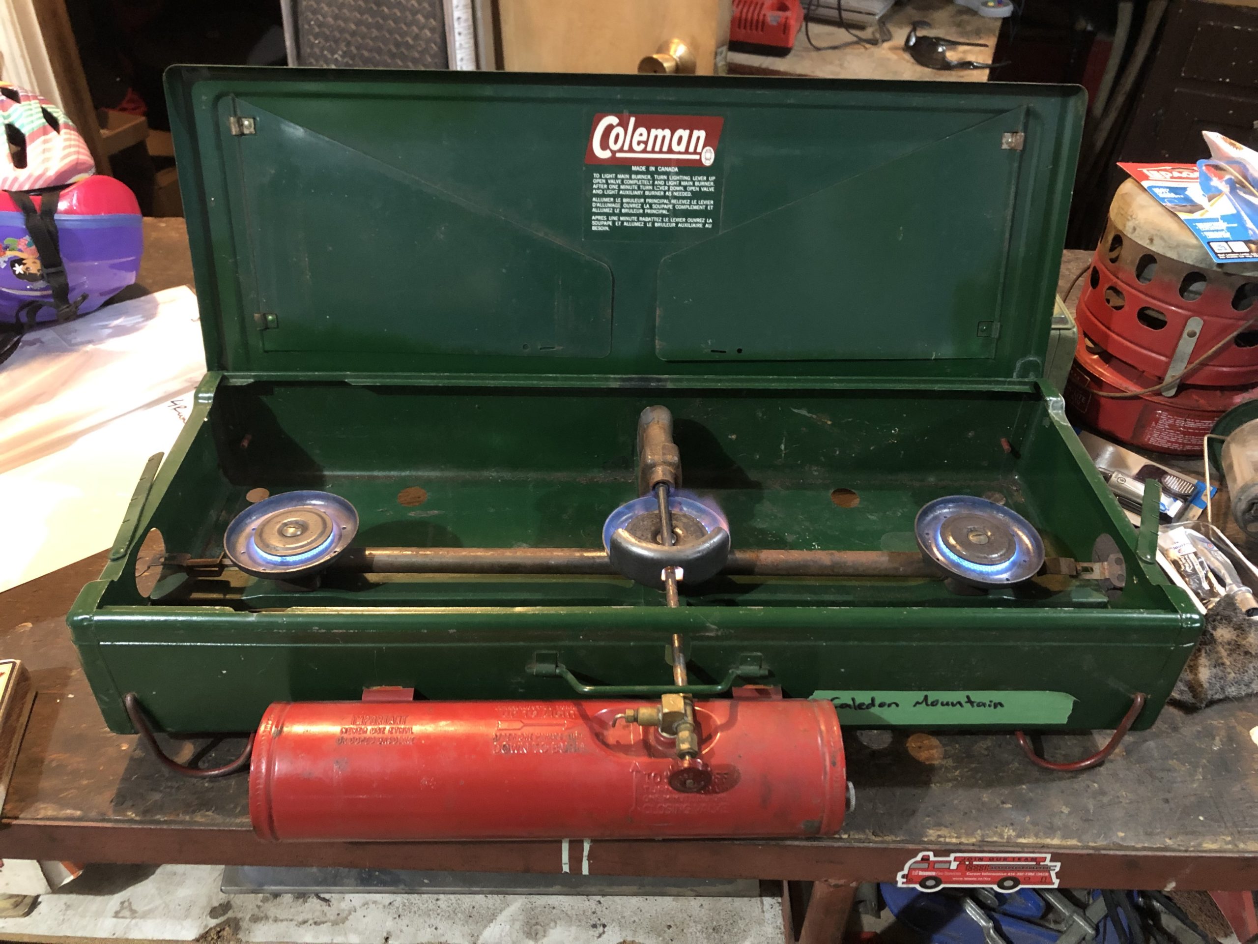

    More Coleman stuff in the shop over the weekend, picked up a Model 446 three burner stove for $10! An hour of scraping and playing with the generator on the tank, and I was back in business, ready to cook a feast.

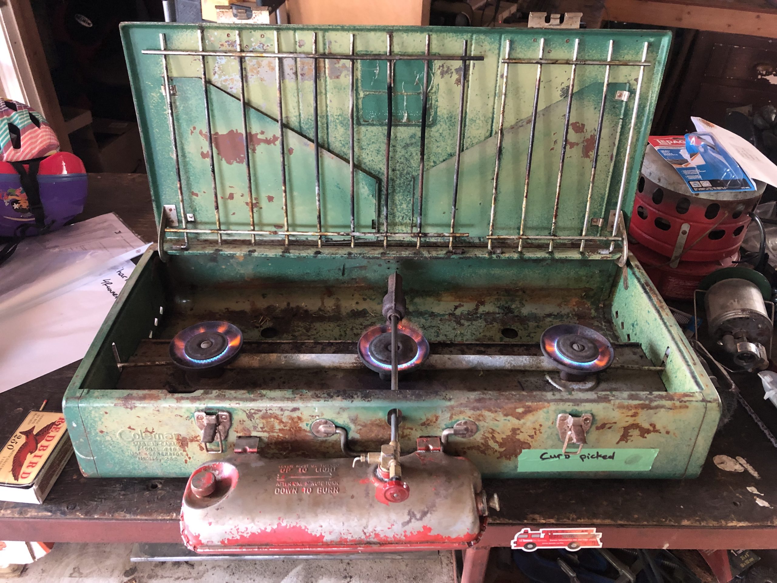

    This is my second model 446 stove, the first one i curb picked a few years back and still need to de-grease it.

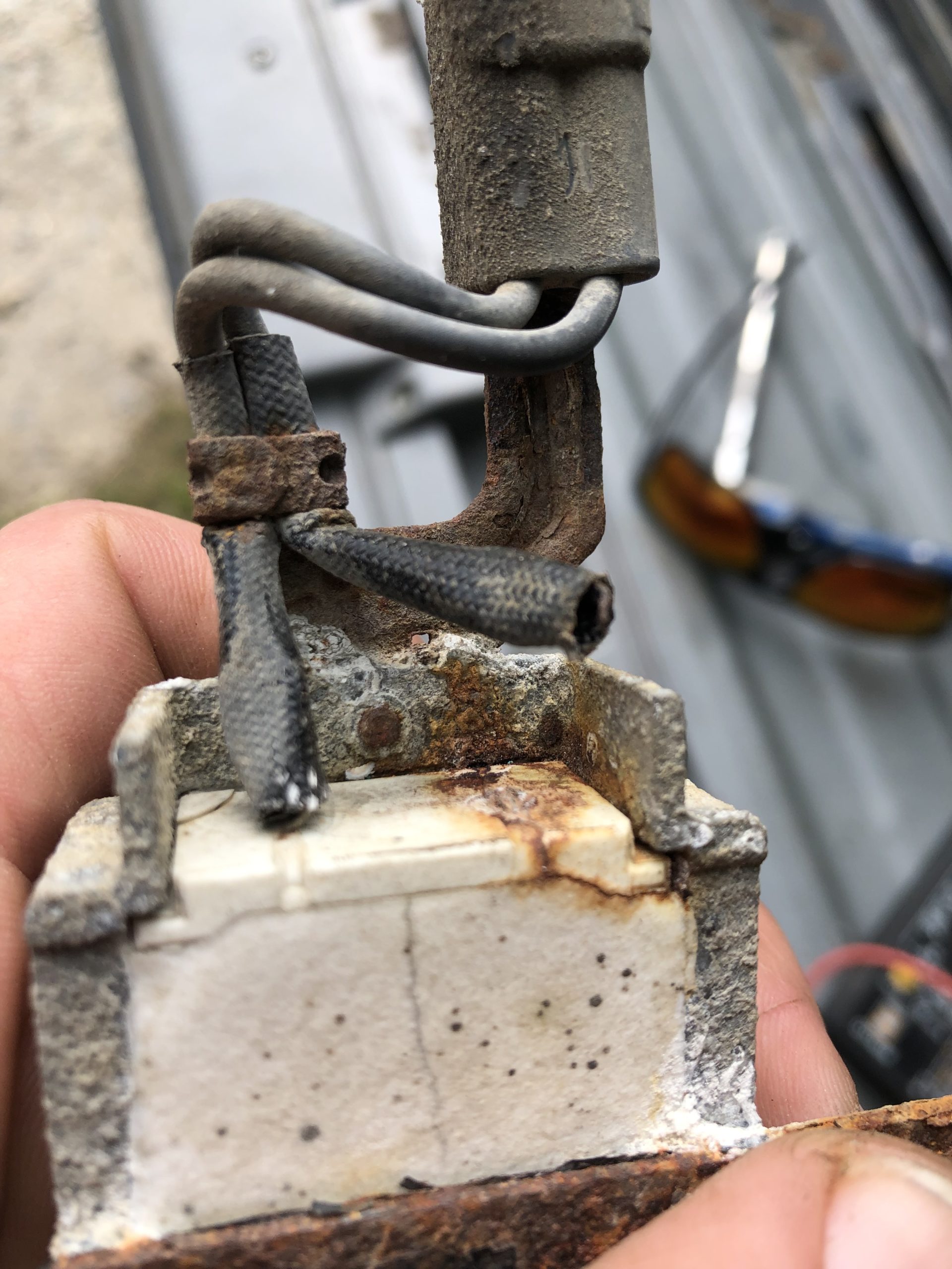

    Still in disbelief that after years of trying to buy a triple stove, I now have 3 of them. One free, one $10, one $40. Hopefully by the weeks end all three will be functional. The most expensive of the three has a small crack in the casting that I’m hoping to get brazed or soldered closed. May resort to two-part epoxy.

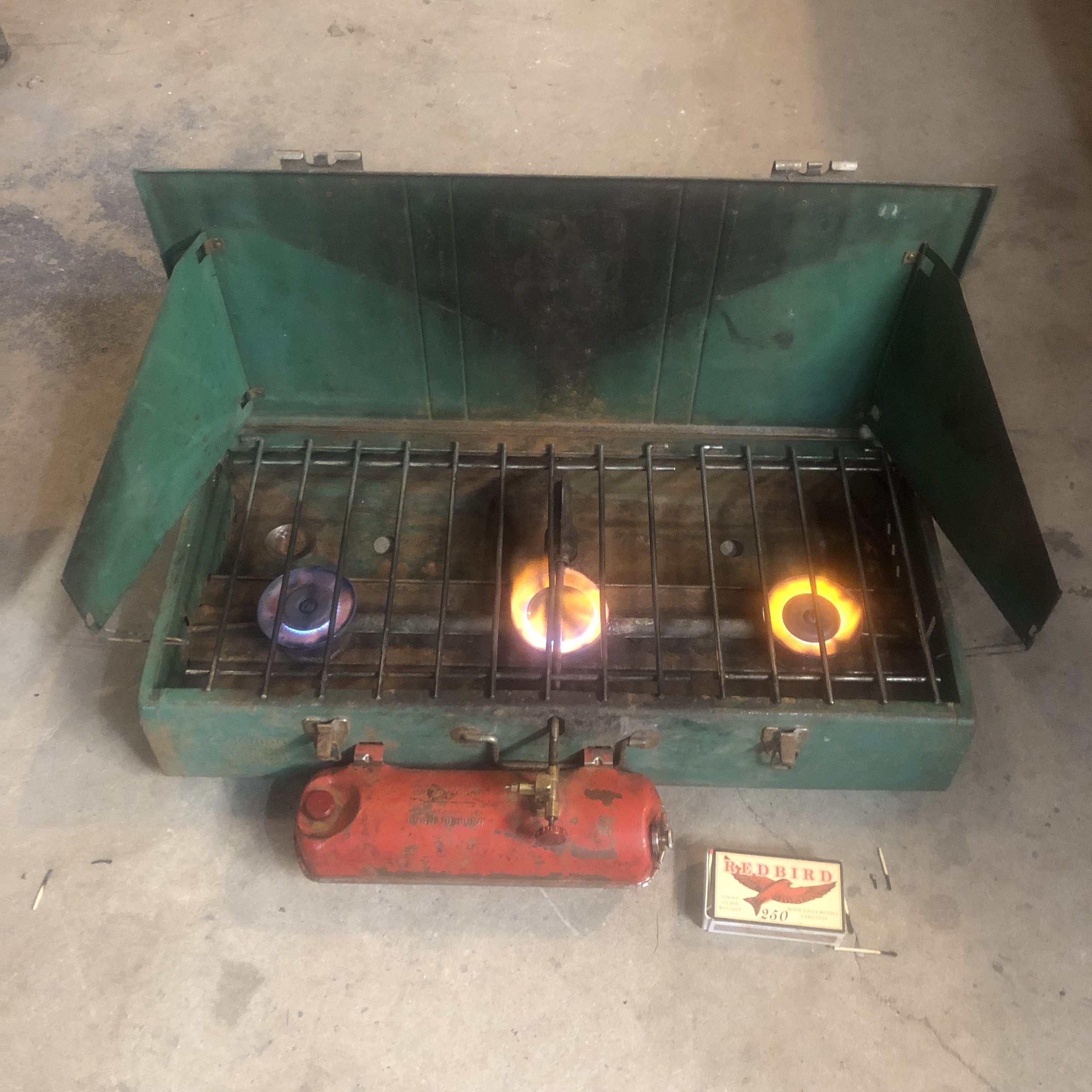

    Last night in The Shop, I fired up the other two Coleman stoves without drama.
    The curb picked stove is still greasy, gonna scrub it at work today. But it runs strong! Might just be the best of the three.
    I repaired the crack with JB Stick in The pretty garage sale stove i bought last year. Then that stove fired up really strong as well. Hard to decide which was more powerful, but i think the curb unit wins.

    That greasy curb picked stove turned out pretty good after a lot of Citrusolve degreaser and red scotch brite. Could have used another 10 mins of scrubbing in the corners nooks and crannies, but lunch was over and I was hot in the parking lot.

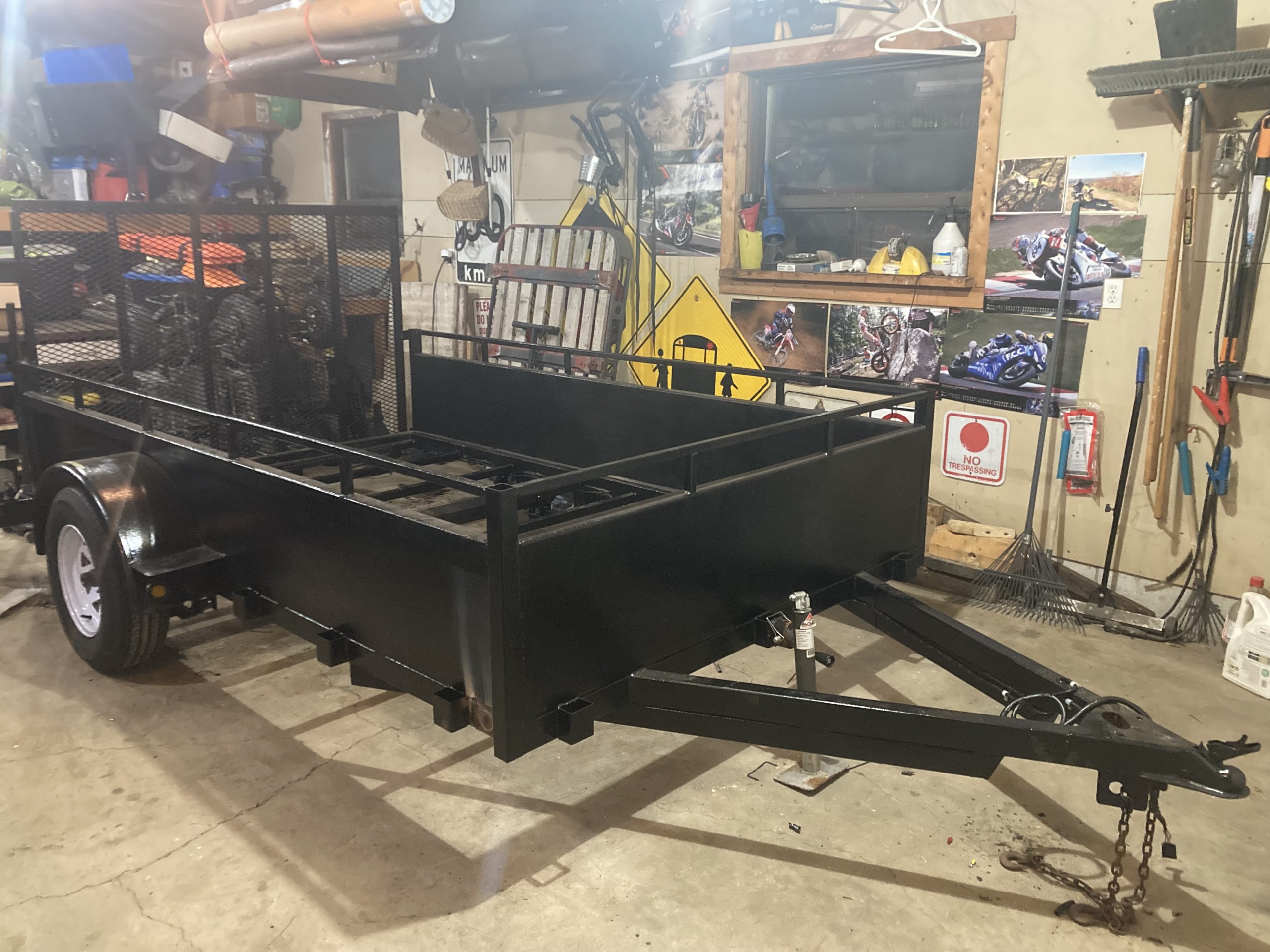

    Had a couple late nights in the shop wiring Matt’s trailer. This was a free trailer that only needed wheels and tires, bearings, lights, wiring, welding, paint and a deck. So it’s been a project for a couple weeks between our driveways. Last night we wrapped up the be wiring and called it DONE! With exception to a new deck that matt will buy and install in the spring.
    We have to make space for a potential new project. Going to check out a Pickup for Matt tomorrow. Bringing a trailer, unless it’s rotten, it’s coming home with him.

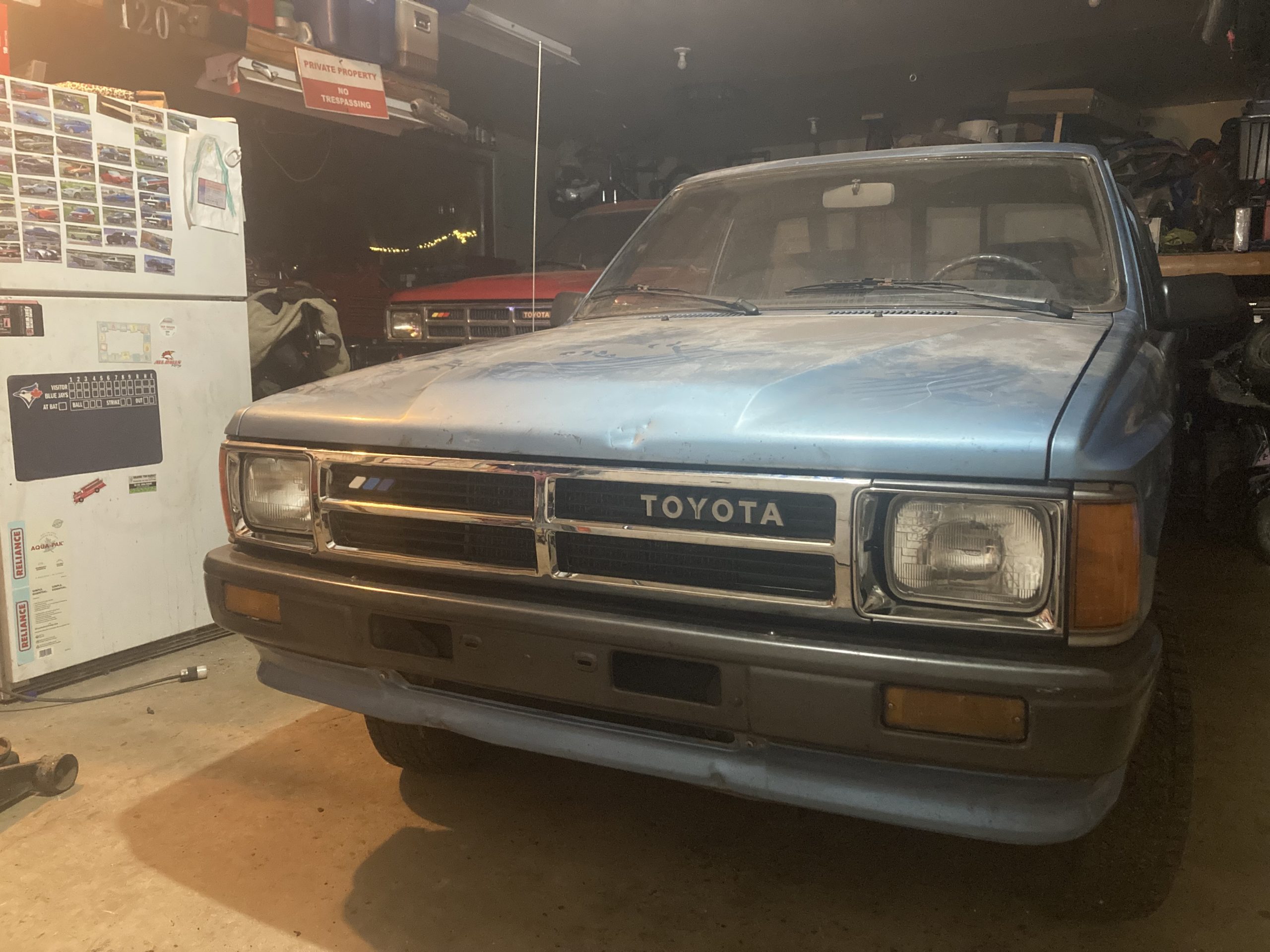

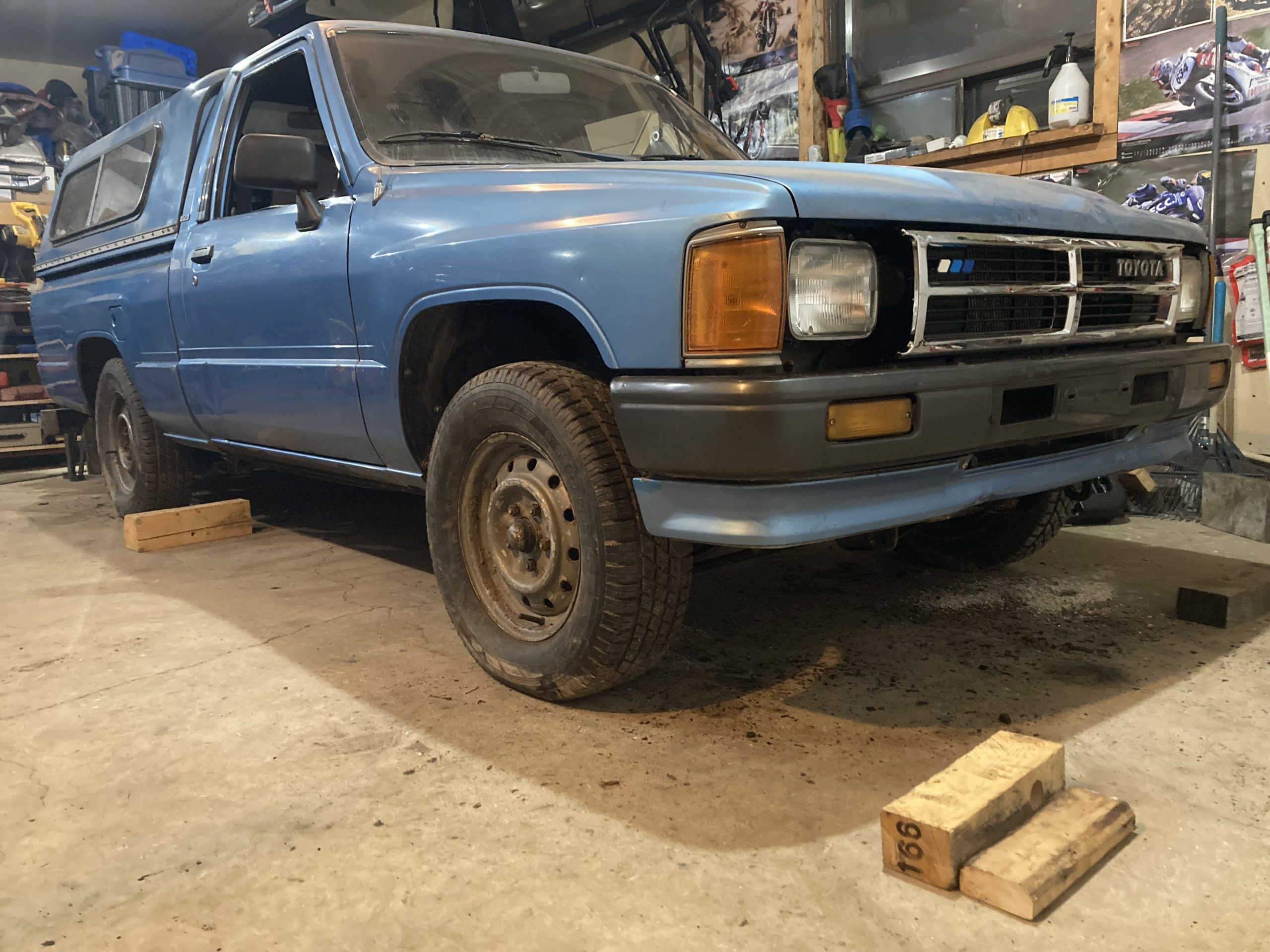

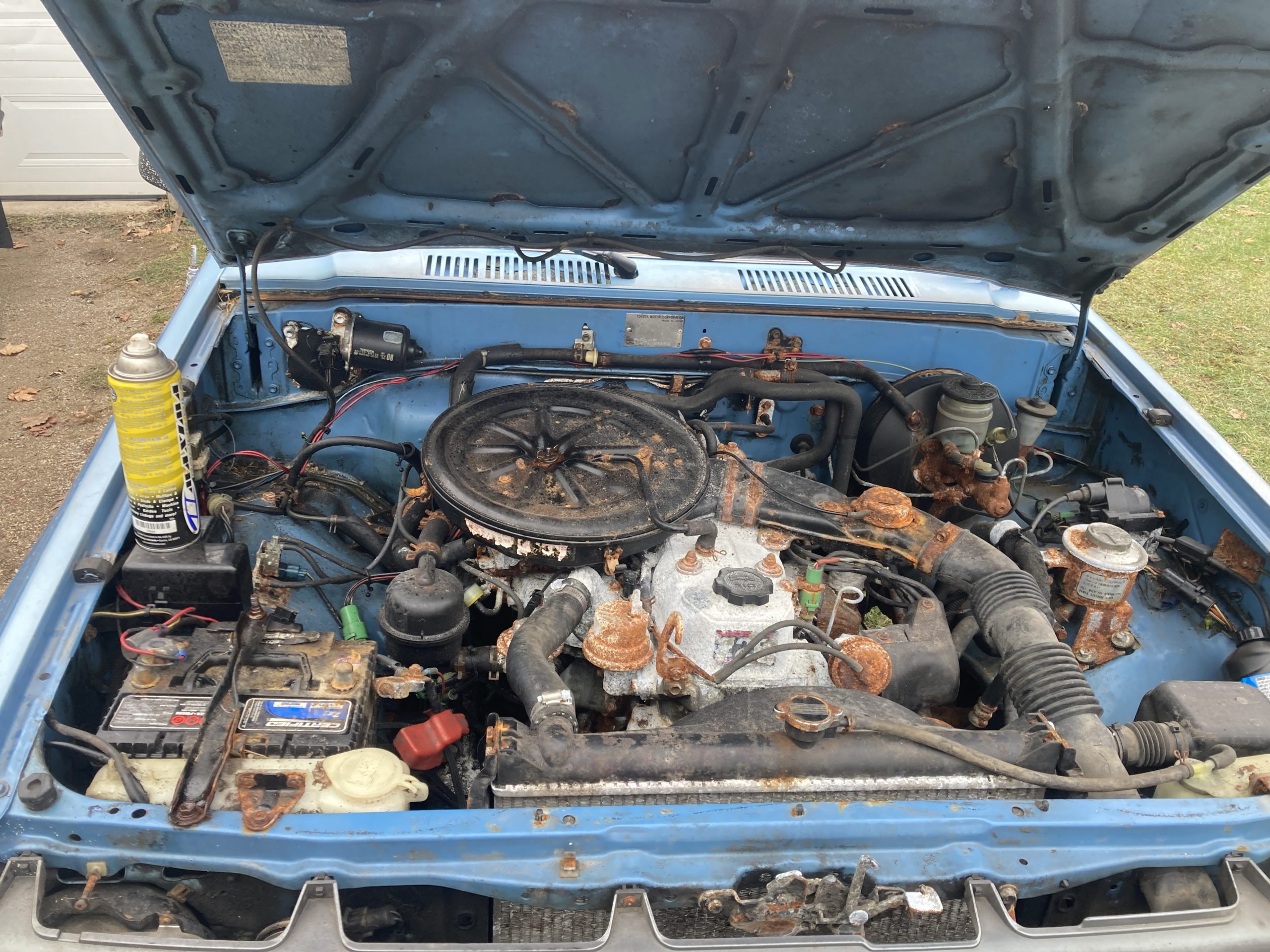

    Been keeping busy The Shop working on a new project, my Buddy Matt bought an ‘87 Pickup 22R, about a month ago and it’s been parked for way too long before he scooped it up.
    Anyways, the short list of work completed is as such; engine unseized, carb replaced with aftermarket OEM, fuel pump, brakes un-stuck all around with calipers pads and hoses up front, steering idle arm, belts & pulleys, sway bar links, distributor cap & rotor plugs & wires, clutch slave cylinder. Still to-do; upper control arms and balljoints, power steering flush, and exhaust patch work on the downpipe.
    Overall it’s a very clean truck, little bit of rust on the A-pillars and drivers side floor. Fingers crossed it’ll pass a aafety as-is, feeling confident.
    Oh yea, needs another cassette deck radio, this one won’t power up.

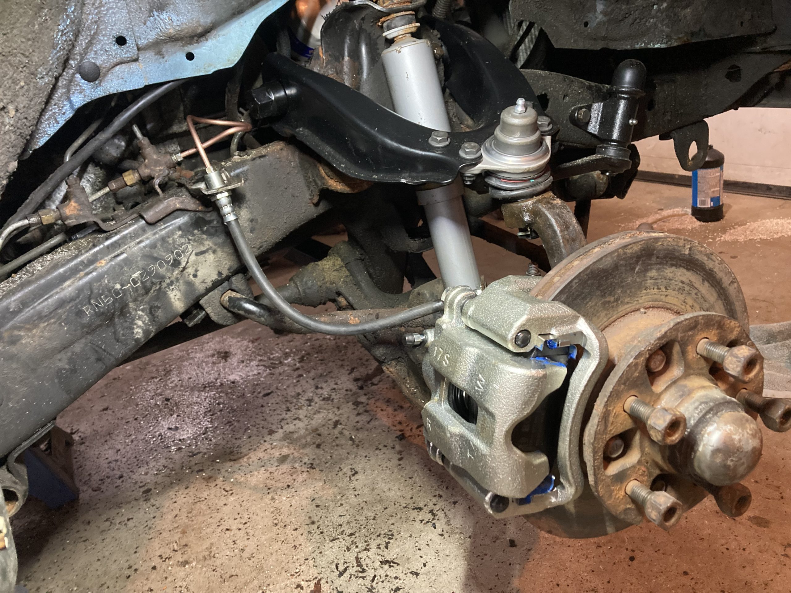

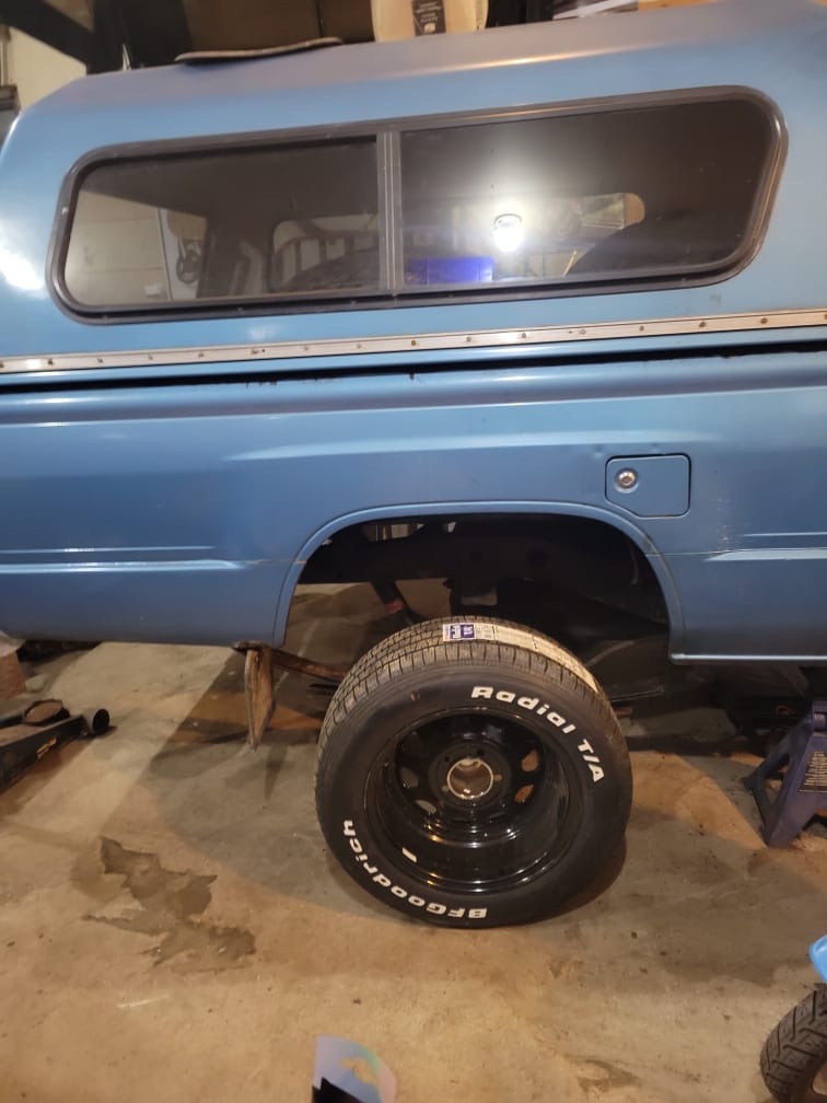

    Made some Christmas Day progress in the shop while working on Matts pickup.
    I was able to bolt in new upper control arms with new ball joints, the new calipers and brake pads, flex lines and one new hard line up front. Previously I added sway bar end links and an idler arms too. With the new brakes in I attempted to bleed the brakes, but both rear cylinders refused; one operated but the bleeder was welded shut, the other would push fluid iut the bleeder, but the pistons were seized in place. So I pulled both drums and replaced both cylinders, along with the drivers side hard line which immediately broke. Brakes were bled, all seem to bite.

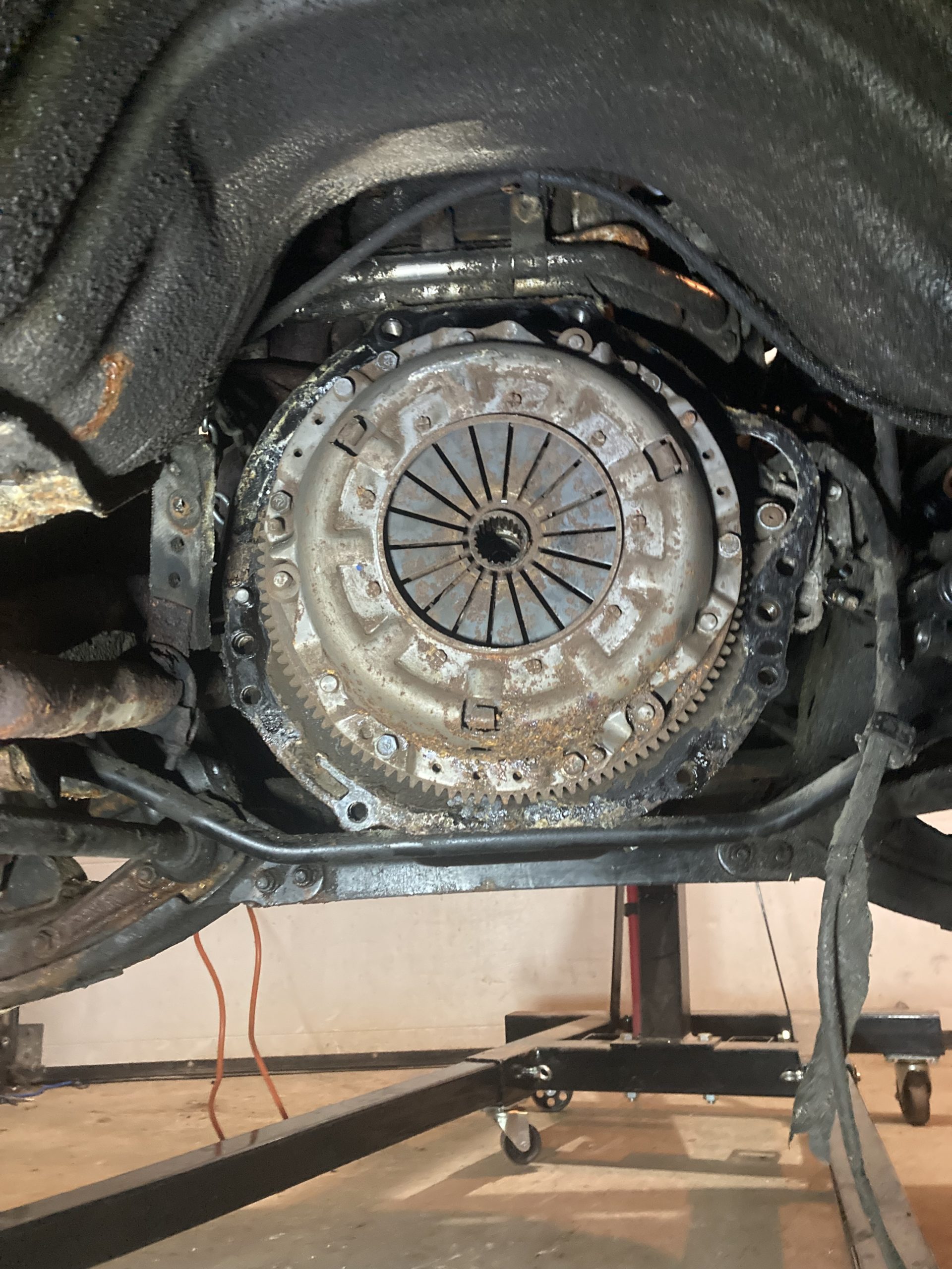

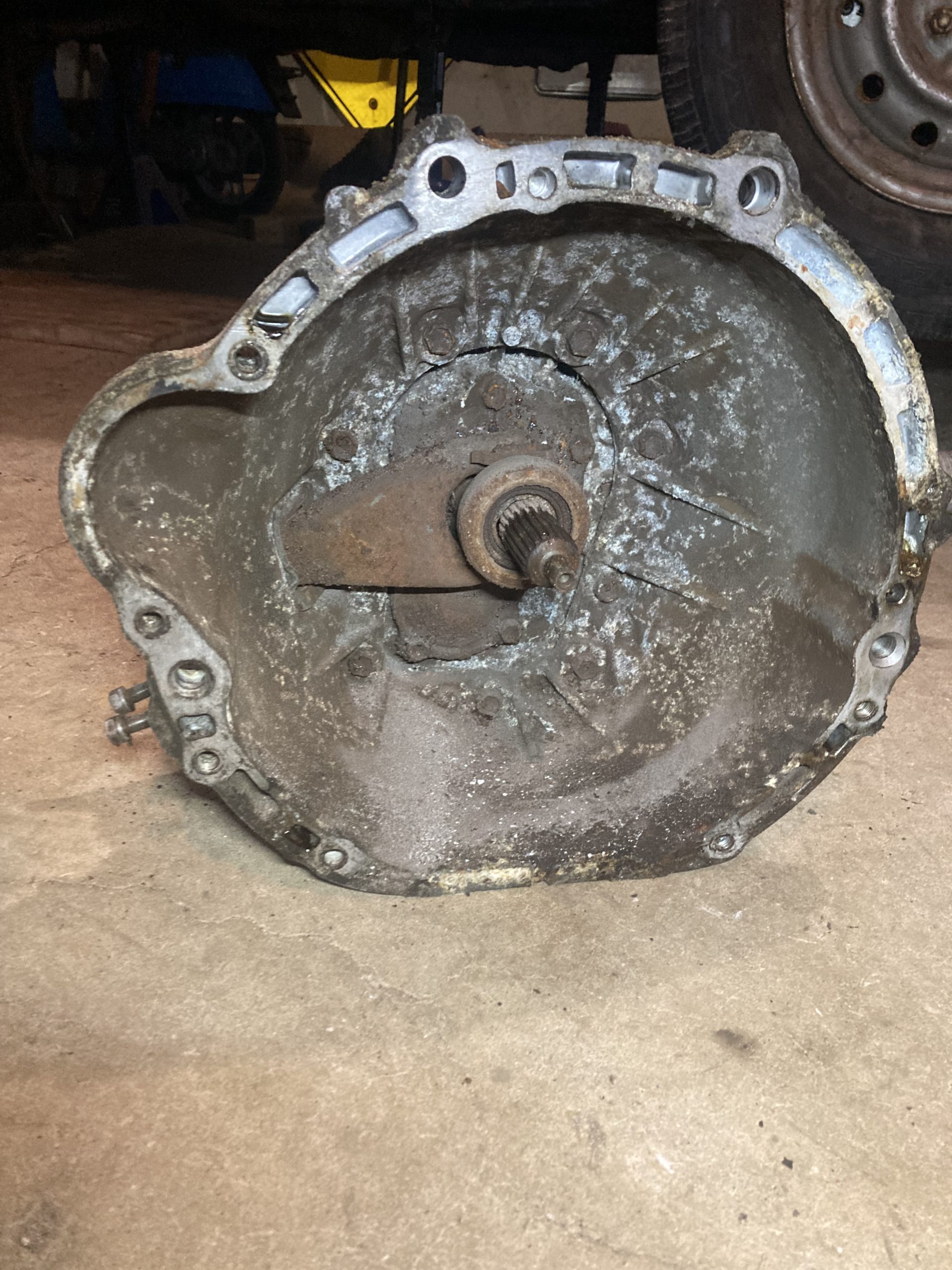

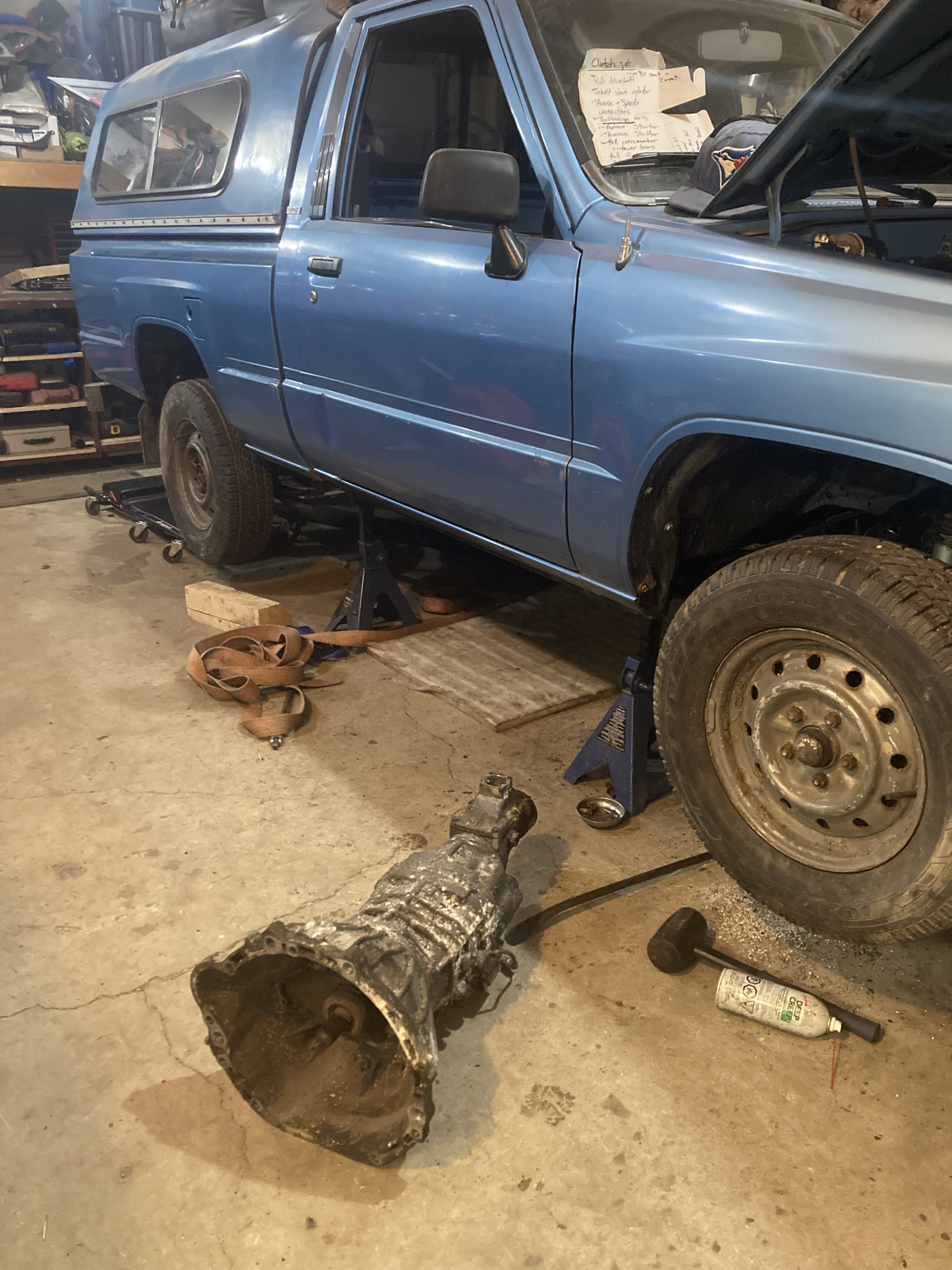

    More wrenching on Matts pickup in the shop. Making great progress on this little truck, nearly done the teardown phase I agreed to do. Most recently last night I dropped the trans to replace the clutch. Had to fight the usual bell housing bolts to drop the trans in matts truck, and some strangeness around the crossmember where it looks like somebody attempted and failed to remove the trans previously. The crossmember has an extension piece bolted on which the rubber trans mount bolts to. The crossmember extension itself was only installed with 1-of-4 bolts, and that one remaining was fully and completely rounded off…. Which reminds me to go to bolts+ and get replacements.
    The rubber mount to trans also has one bolt broken off in the trans, which I’m not worried about, 3/4 should suffice if I can’t extract the broken piece.
    Anyways, now that the trans is out, pretty clear to see that the pressure plate is FUBAR. No arc (preload) on the diaphragm springs at all, they are flat or slightly inverted.
    Rock auto clutch kit and flywheel should arrive by tomorrow. Gives me time to pull the clutch and flywheel, get hardware, and swap out the downpipe for the NOS part matt grabbed in the states last week.
    Hopefully this test drive happens in the next couple days. Fingers crossed reassembly is smoother than the tear down.

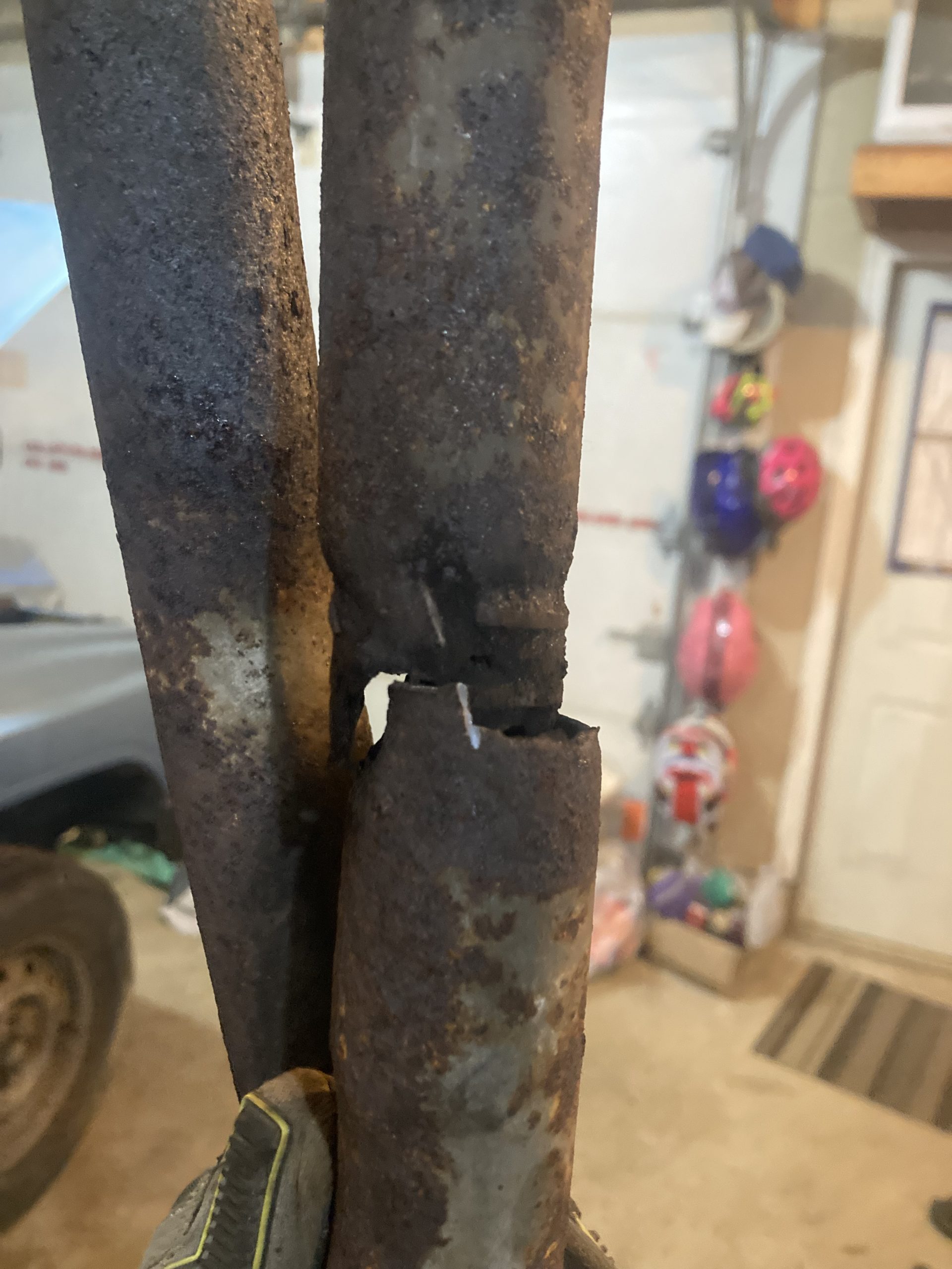

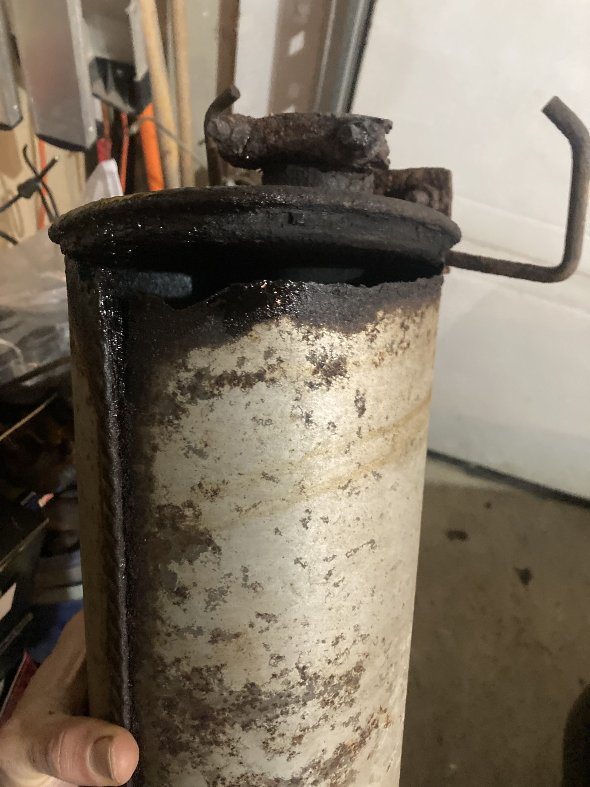

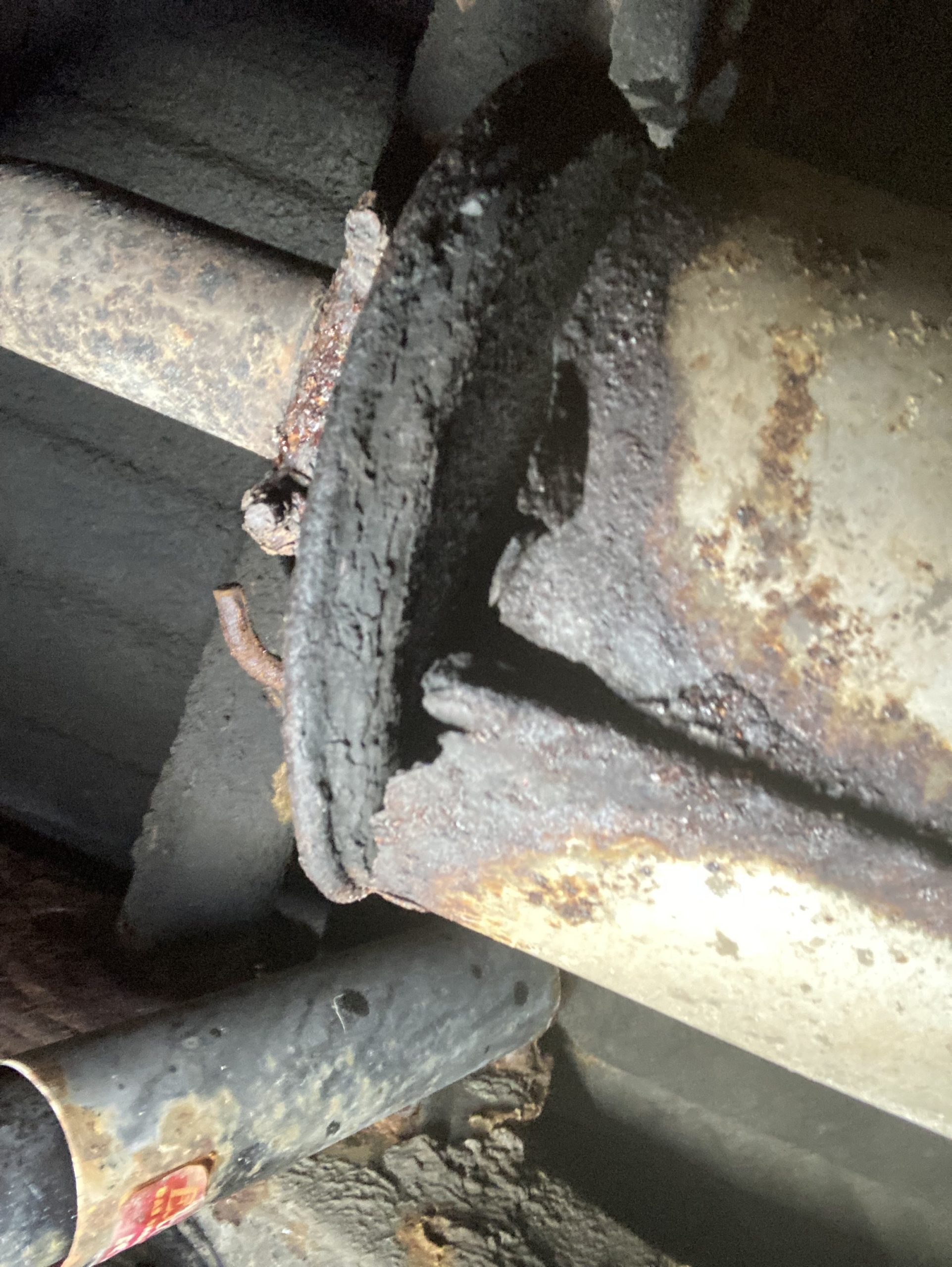

    Negative, the alternator doesn’t work, and the muffler went KA-BANG leaving the last stop sign. Matt and I jumped and nearly shat, my fear was the BANG came from the driveline.
    Anyways, alternator is on order locally, muffler is going to be replaced with a curb unit i have in the shed, trans fluid will be drained and flushed, and power steering flushing.

    I dug through the shed of curb-picked stuff and uncovered a muffler for matt. A pair of reducers to get the ID to match the teeny tiny stock pipe, and she’s exhaling in a muffled manner once again.

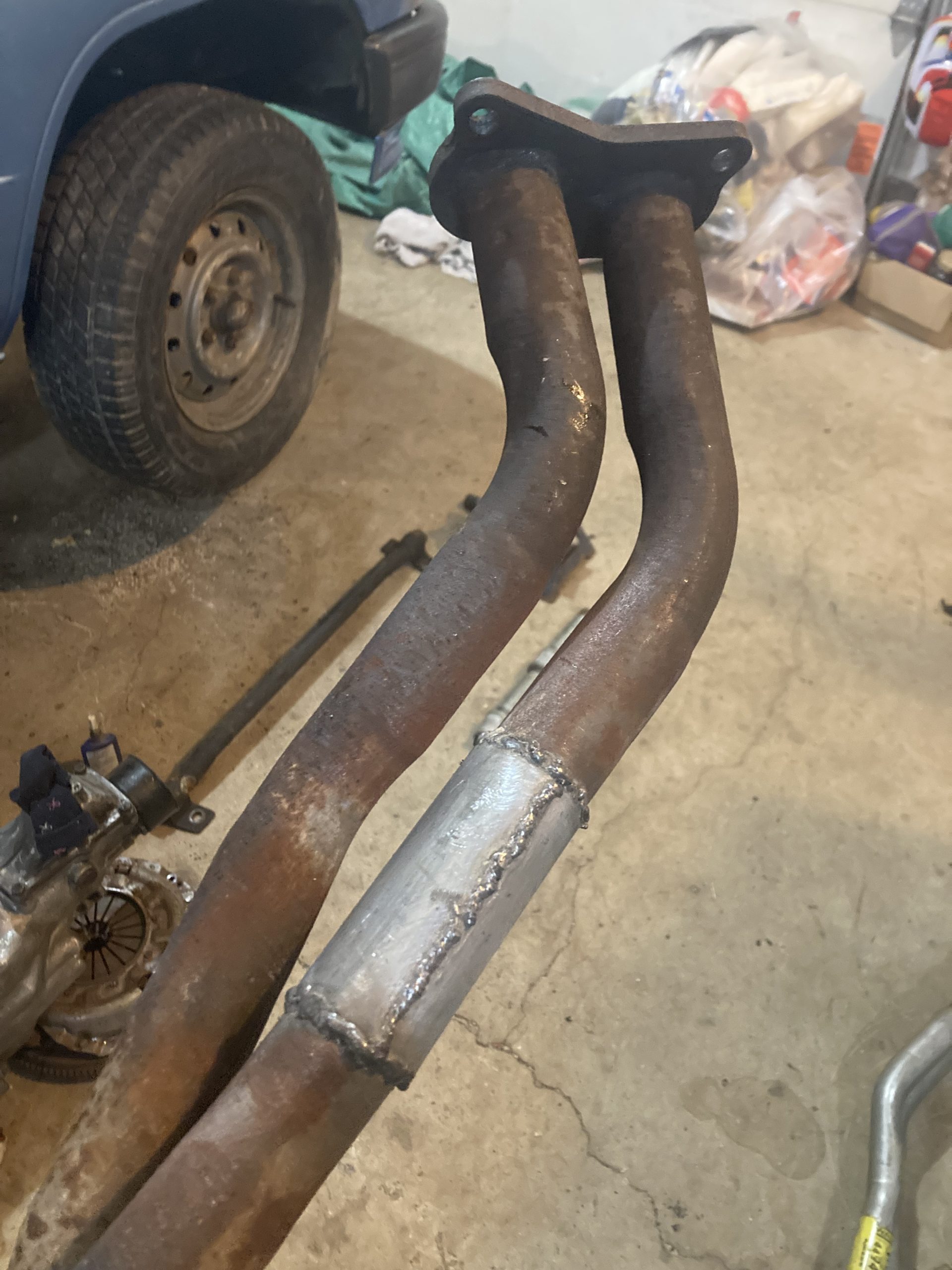

    Pics are the exploded muffler, and the downpipe before I welded a sleeve in place. Think it turned out well for how rusty the tight clearance I was working with.
